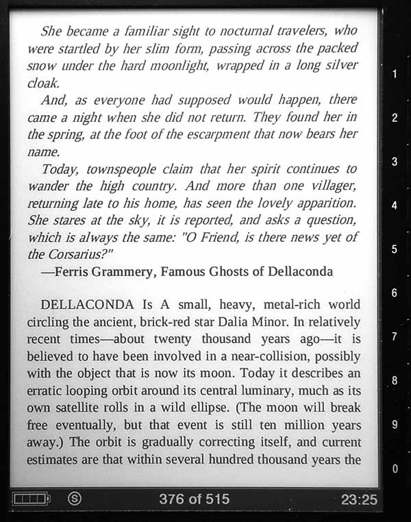

All done and I like how Liberation Serif looks so I thought I would share a screen shot. I have also attached the modified font file for use with PRSCustomizer. Thanks to Valloric for the guide!

You're right, it looks great ! Thanks for the screenshot, it's very nice to see a font in action ...
