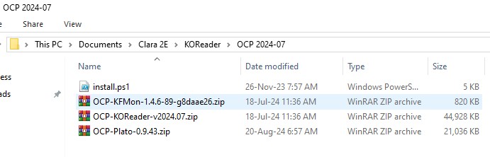

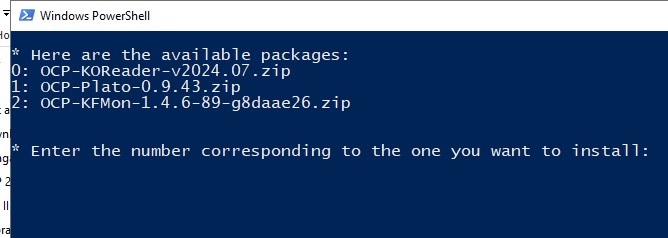

Originally Posted by Raver View Post
Thank you, no, I didn't install the combined package but only the Koreader one.
If I want to install the combined package, or add the Plato package, can I simply install it over the Koreader or do I need to remove/disinstall something before?
And what will I need to do to install future updates of these packages?
Thanks and sorry for the dumb questions
If you already use the One Click Install Package to install KOReader.
You just need to download OCP OCP-Plato-0.9.43.zip from https://www.mobileread.com/forums/sh...d.php?t=314220, and put it in the folder OCP (image1), and run the install.ps to install Plato (image 2).
According to image 2 is no.1
