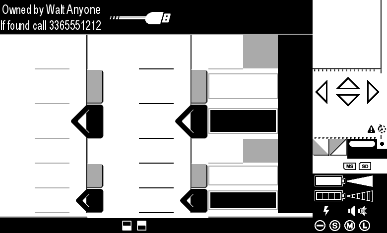

Old 03-13-2010, 05:22 PM   #745
surquizu
surquizu ought to be getting tired of karma fortunes by now.surquizu ought to be getting tired of karma fortunes by now.surquizu ought to be getting tired of karma fortunes by now.surquizu ought to be getting tired of karma fortunes by now.surquizu ought to be getting tired of karma fortunes by now.surquizu ought to be getting tired of karma fortunes by now.surquizu ought to be getting tired of karma fortunes by now.surquizu ought to be getting tired of karma fortunes by now.surquizu ought to be getting tired of karma fortunes by now.surquizu ought to be getting tired of karma fortunes by now.surquizu ought to be getting tired of karma fortunes by now.
surquizu's Avatar
Posts: 411
Karma: 902071
Location: Zaragoza (Spain)
Device: prs-505, kobo auraHD, kobo auraH2O, kobo Glo HD, kobo aura ONE
Originally Posted by Peto View Post
Logo and icons, but you can add language sets also.
With the flasher Igorsks also can put your own custom title on the main screen
