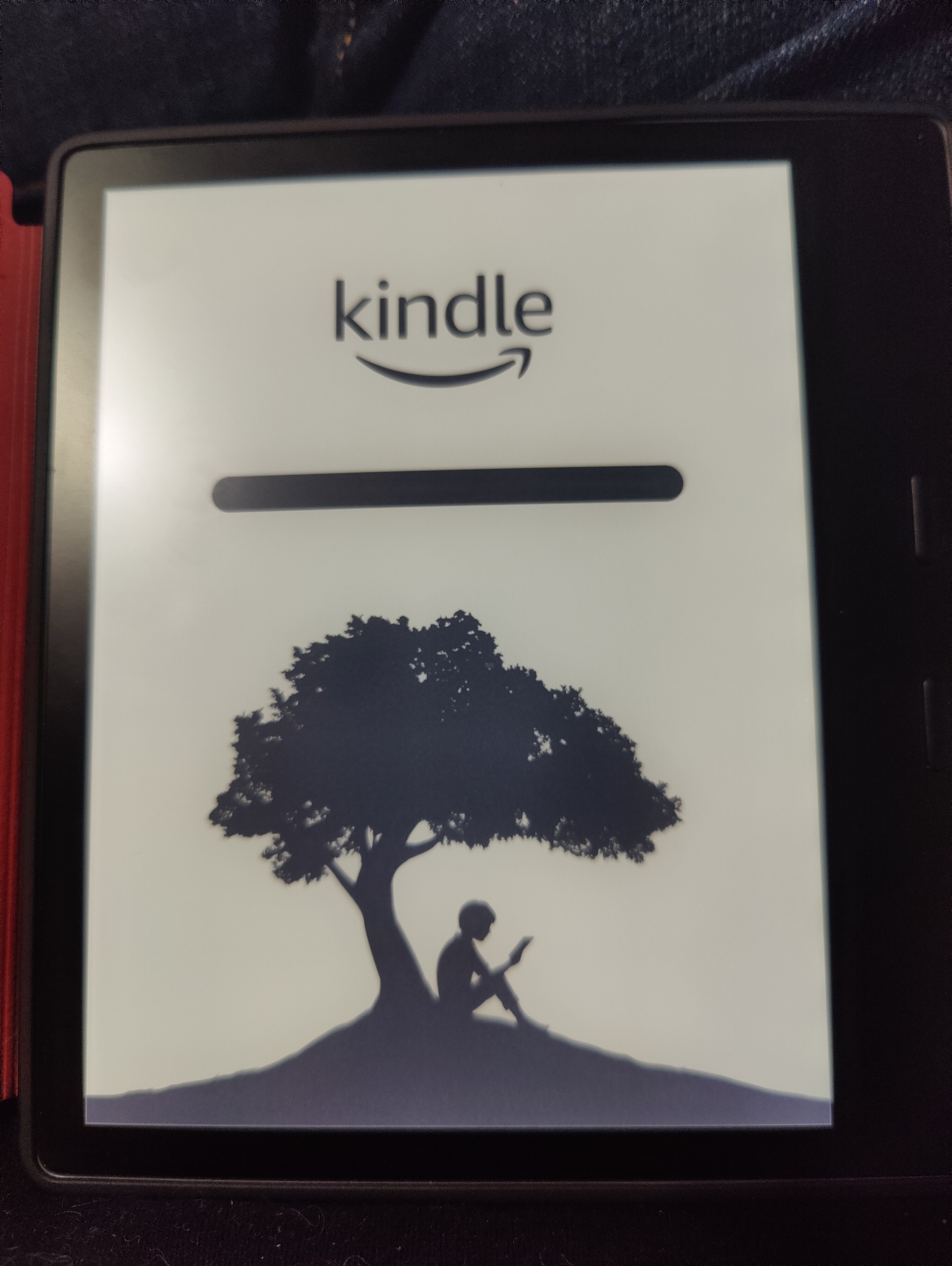

KOA2 Showing Kid reading under a tree only.
I get stuck on that screen when I try to use the Screen Savers. Here is a picture of the kindle and the file I am attempting to use.
I noticed that if I flip my cover it will in fact load the digimon picture I have. But once my screen saver goes away it will load that image of the tree. If I connect my kindle to usb and disconnect it then the tree goes away and I can use the kindle.
Not sure if this is the same as being stuck on the last screen issue.
I edited all my images in photoshop and manually made sure they were all the correct resolution and format. They are even greyscale I don't know what to do...

Is that what's shown instead of the ScreenSaver (which wouldn't make sense), or is it actually stuck during the actual boot process (which would possibly make more sense, although I've never seen it happen).
IIRC, the Oasis 2 can run a FW w/ native screen saver support. And this has *never* been tested on such FW versions.
It is not stuck during the bootup process for certain. The best way I can describe it is: Whatever was last on the screen is what the screensaver will be shown as the screensaver but on top of that the screen will NOT refresh if you unlock the device. Either it attempts to unlock and fails OR the screen does not refresh even if you touch buttons or the screen that should make it change what's on the screen. Now I found only ONE way to get around that. Which was to plug it into my computer. it would then change the screen and when disconnected would function when unlocked but either show that image again or show what was last on the screen and once locked wouldn't function properly again.
After extensive attempts at figuring out what was incorrect. I believe it is most similar to this issue:
"Q. Get the last thing shown on screen (or a blank screen on FW 2/3/4) in cycle mode, either straight-away or after a few working custom images?
A. One of the files in your screensaver pool upset the Kindle firmware . That rarely happens on FW 2/3/4 (you're much more likely to see a corrupted image, rather than breaking the whole thing, which is what happens on FW 5.x: once it fails in this way, only a reboot will make the framework try again, even if the next file in the cycle is okay, the framework just appears to give up on screensavers), but on FW 5.x, that means checking the size, format, resolution of each and every file in your pool, to see if it matches the device, and really is a PNG8 (256c) (optionally properly dithered down to 16 colors, but not indexed to 16c), without any embedded ICC profile."
While I did read the initial instructions, "One the KV/PW3/KOA: PNG files, 1072x1448. Grayscale if possible, but color works too (you can even play with an alpha channel if you like)." is what I followed. I did not know about it having to be a specific version of PNG8(256c), dithering, and index. I at least didn't embed a ICC profile.
But I think what would solve all of that, is to provide Sample files for each version that works. Specifying PNG8(256c) in the install information would be helpful as well but I am betting that most people will not know how exactly to do all of those things when making a new file. Simply providing a properly formatted color file will allow anyone to use it as a template reducing responses related to that particular issue.
I will be honest I am assuming PNG 8 means an 8bit PNG, 256 is the number of colors though I am going to need to look at how to implement the dithering and ensure it's not indexed.
Currently, I have it showing my Gallantmon file since I corrected the "256" issue. Though even though it is the correct resolution it is not being displayed full screen...
I am sorry for being such a noob I dont know what you mean by "FW w/ native screen" specifically "FW and w/" Full Width?

FW = firmware.
"native screen saver support" = Kindles since IIRC firmware 5.13.4? havs had "native" / built-in "book cover as screensaver" functionality.
And this hack predates that built-in feature and also was never tested on those newer firmware versions.
In any case it can't be a clever and good thing to have that built-in feature enabled AND at the same time try to use this hack.
So that would be my question to you: do you have "Display Cover" (Settings > Device Options> Display Cover) set to "on" or "off"? (and do you have that as a first option inside Device Option section at all?)
Also what exact firmware version is currently installed on your Kindle? You can check that by doing: Menu > Settings > Menu > Device info(rmation).

1: I do not have the option for display covers at all.
2:I am on 5.14.3.2

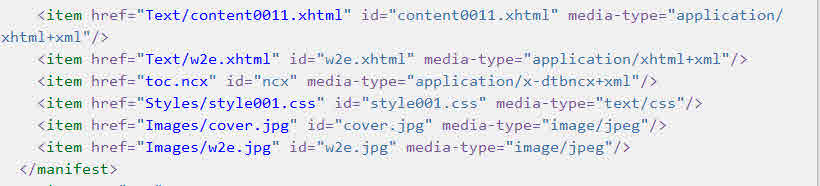

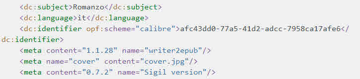

It's been quite a while since anything relevant was updated, but there was a KFX tweak (I don't really remember any details, though) a couple months ago, so you might have been using an older version.
Bringing back an old item... Maybe I am the only one who is consistenly using SS hack and KFX but... no, SS hack keeps showing the wrong cover image 90% of the times, even if the correct one is marked in metadata. For example, see the attachment (of the epub version): only two images in the book; one of them correctly identified as the cover in metadata... ans SS hack displays the other one.
You might say the "real" cover was somehow in a bad format? But it is not. I removed the other picture (and the only html line where it was displayed, which was something like "created with Writer2Pub" and the the inline code to place the image).
I re-converted the epub to kfx, and now the correct cover image gets displayed.
Of course this is not a solution, as it is not always possible delete all other image different than the cover, but it shows the "real" cover is actually a good image... but ss hack consistently choses the wrong image to display as a cover when working with a KFX.
At least that is my experience.
