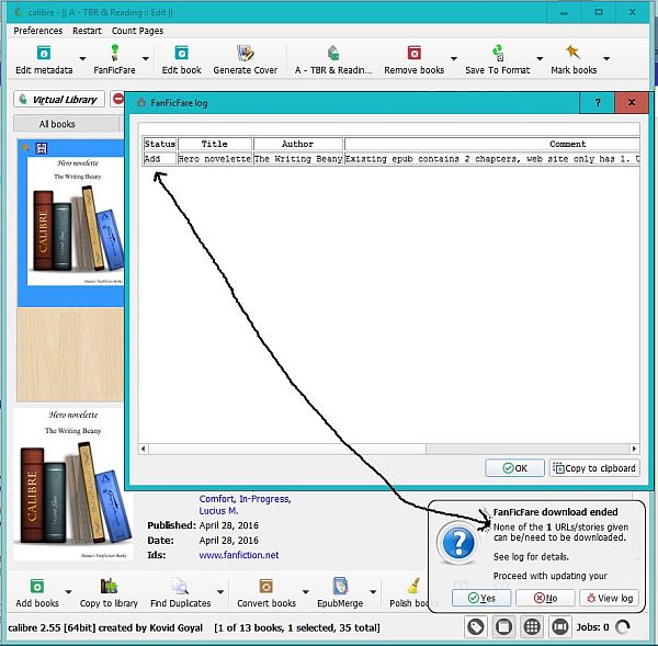

Hi, this is not a problem for me, but it might cause problems, or confusion that I'm not aware of. I tried it both before and after latest test version, only because to show you example, I had to recreate, and that was after LOL.
A story I needed to just update the titlepage, to show the changes I've made to the contents (streamlined fandoms, changing packaged date to show original, rather than update, page count on title page -- I use option "Update EPUB Always"). For some reason, there were less chapters on the site than in my file, so it said that it had none to update, but the Log still said 'Add' but explained why it wouldn't update. That sounds complicated even for me, so see screenshot.
It might be correct for reasons I don't know, but just thought I should point it out. I'm guessing this might also come up if there is a confirmed update to a fic, but the author consolidated chapters and ended up with less than before? Hmm, might fool around with a fic just to see...
I've committed: "Change log status of NotGoingToDownload books to 'Skipped'." It will be in the next test version and release.
