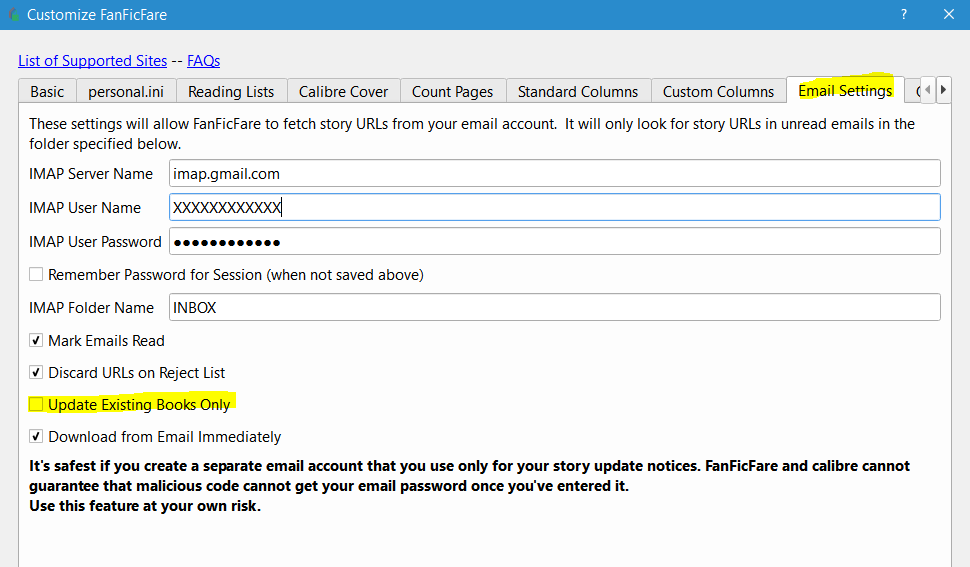

New test version posted (direct link)
2016-09-08
- Adding Update Existing Only option to Email URL Fetch.
Originally Posted by glenm125 View Post
Is there any clever way for fanficfare to ignore chapter notification emails for stories that aren't in the library yet? Or another way to accomplish same? Note that an Ignore list won't work, because the whole point is that I don't know what stories may be authored, I can't know the IDs in advance to Ignore them.
JimmXinu is online now   Reply With Quote
