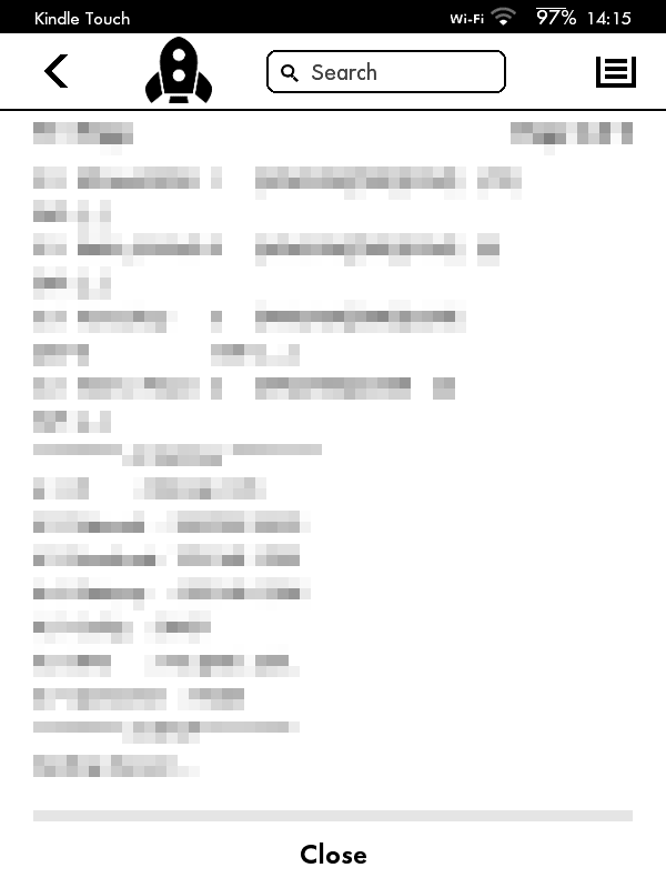

Battery % in the tray - KUAL app for kindles is now READY!
Finally we have a tiny app to display the battery % in the system tray. All credits for this go to Eureka (see this post for the original code: https://www.mobileread.com/forums/sho...87&postcount=8).
I've only set up this KUAL launcher and tuned a bit the layout to give it a native look on Kindle Paperwhite. I couldn't test it on Kindle Touch, so every feedback and screenshots on this device are welcome.
Once launched the KUAL shortcut, changes will persist until the next system (or framework) reboot. Its work range is 10%-100%
If it doesn't show the first time, restart kindle and retry.
Update: now it should work properly both on Touch and PW
Update 2: it has been reported that on touches devices it shows in different ways depending on the firmware version. Try to play with marginLeft and marginTop values in the script to fit better your needs, reapplying the patch each time you change something.

Sucess on a Touch! Looks pretty good - there is a tiny line above the 99% that looks like it might be from the battery icon. Still usable, just not perfect. I haven't looked at code yet.
I'll make two different versions then. If you post the screenshot I'll try to fix it! Just have to change a single value. Thanks for report

Yes, you must plug off it, take the screenshot then plug it in again.
Try to set _batteryMeterEl.style.marginTop="-1.6pt";

yep, much nicer. Thanks! I'll probably play around with the numbers a bit to see what I like best.

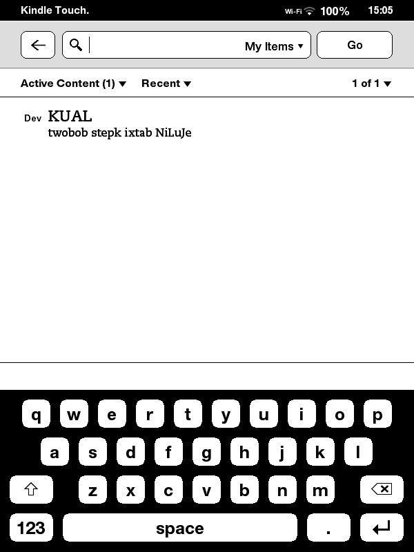

small note..
There appears to be a minute disparity in Touch FW versions...
Pictured. Ancient and New.
So, yeah... Just mentioning it.
