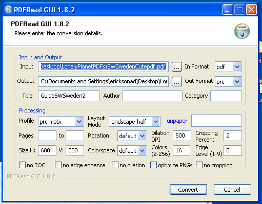

blank pages
Ok, I'm making progress!
Next question: why do blank pages appear on my K2 between the document pages when I use landscape-half? Nothing from the document seems to be missing--it just inserts occasional blank pages. I'm attaching the settings I am using.
Next question: why do blank pages appear on my K2 between the document pages when I use landscape-half? Nothing from the document seems to be missing--it just inserts occasional blank pages. I'm using these settings: Profile: prc-mobi, Layout: landscape-half, Resolution: 600x800. Ideas?
Try using a resolution 520x622 instead. It was recently found to be the max. screen size of the K2. Those blanks pages may be caused by using the K1 max. screen size or an aspect ratio different than the K2's i.e. 520/622.
If you use 600x717 it may work as it is in the same aspect ratio i.e. 600/717 = 0.836 = 520/622. But, I'm just guessing though as I don't own a K2.
Please confirm if this does or doesn't work.
Neither of those worked for me--still blank pages, maybe more than before. I think the resolution might be the problem, though. I'll keep tweaking it and see if they disappear. Thanks!
In another thread a solution was to not use the .prc created by PDFRead, but instead create the .prc using Mobipocket Creator from the .opf left behind with the images. (Make sure to use the empty 'debug' file trick.)
Even MobiPerl's html2mobi may fail to create a .prc ebook from that .html with no blank pages within.
Worth a try if all else fails!
