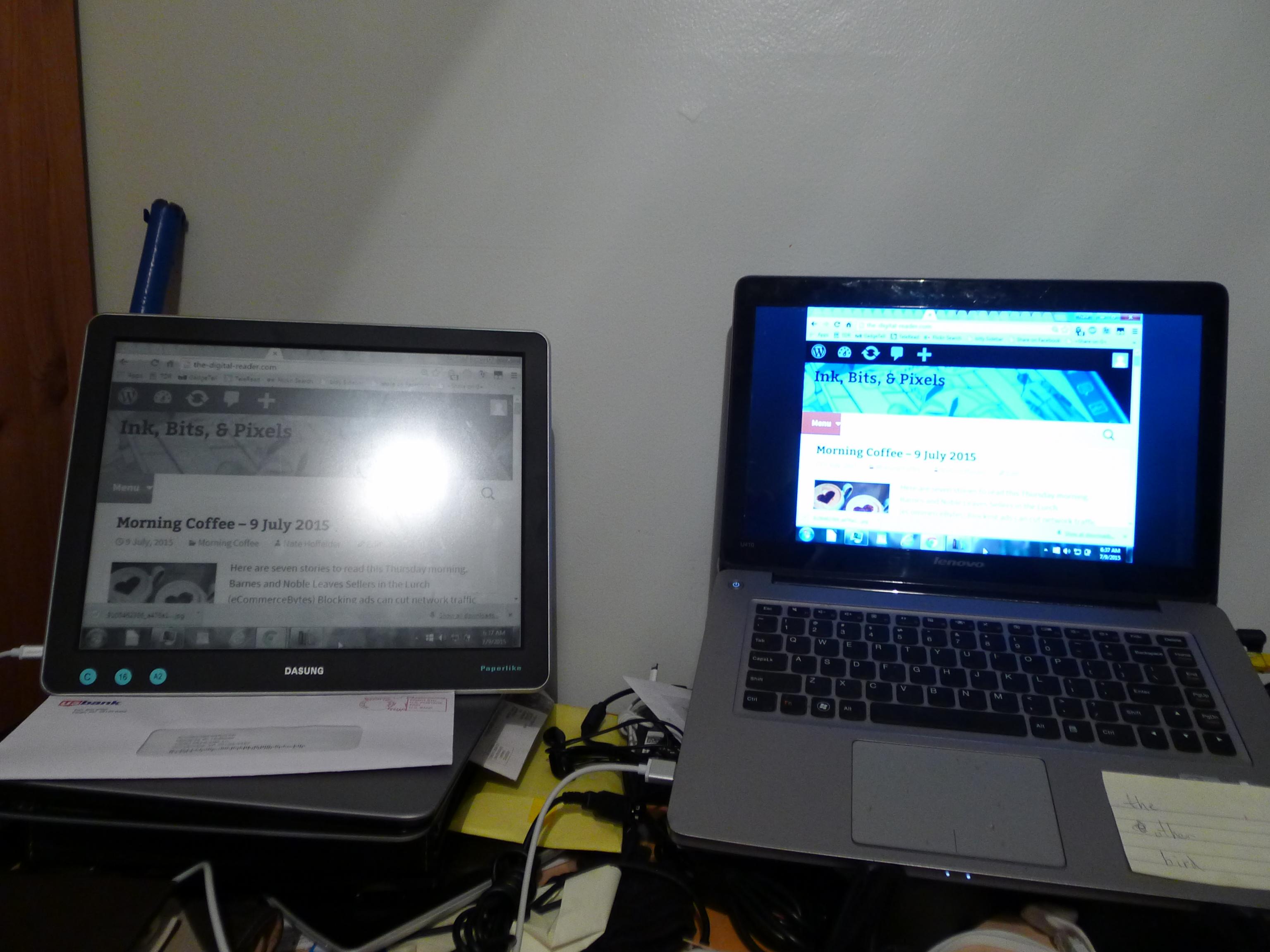

I got it to work - once.
I still haven't gotten the external monitor option working.

It's mostly working now:
http://the-digital-reader.com/2015/0...monitor-video/
