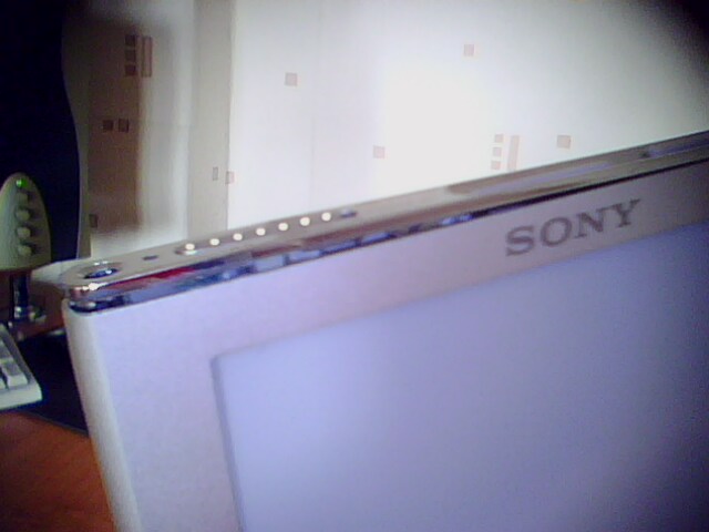

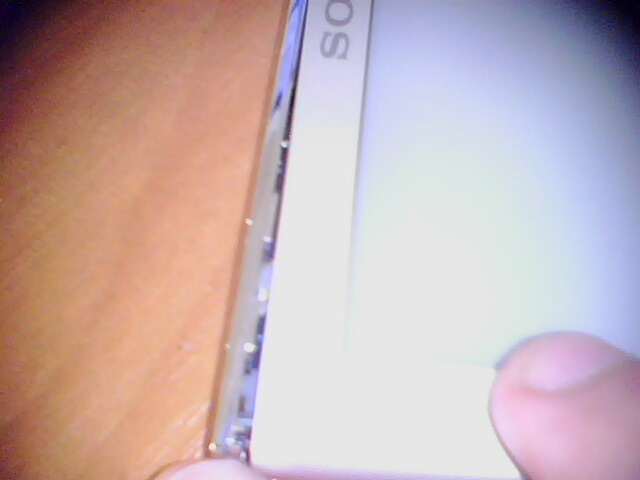

Broken top panel. How to fix it?
Well, I got the reader today...
And it was...broken by some STUPID IDIOT at our customs who checked the parcel!!!![/B] Oh God, I waited this reader so long, and now I have to fix it before using.
Like the previous time, when they broke the fasteners in cover, NOW they broke not only the fasteners, but also the top panel (see on photos, sorry for the quality I used my phone). Reader is fully working (I charged it), but I cannot turn it on or turn it off...
If anyone could help me to fix the problem - it will be much appreciated!

I don't know how to fix it, but you should be able to turn it off using the software and on by plugging into USB port on Computer.
Best is to return it and wait agin. Sorry not much help

Thanks for help but I bought it from person, not from the shop, and I saw the photos before the reader was sent to me. All was OK.

Looking at page 6 of the Sony repair manual, it looks as if the top plate is only held in place by the two small screws on the back of the device aprox. 1cm down from the top. They are the only screws in that area. Perhaps they have stripped out?
Why not download the service manual from Sony? The pictures are very clear.
Stitchawl
Do you have a link for the service manual?

The manual is an attachment in this thread. Good luck!

BeTePok, Sorry to hear of your misfortune. I have replaced that top piece on my own 505 after a mishap. Following the diagrams and instructions in the repair manual, it was one of the easiest fixes I have attempted. There is very little disassembly to remove that part.
You can order a new one at: https://servicesales.sel.sony.com/ec.../web/index.jsp. Enter part number A1362416A in the search box, and select Part Number from the drop down box next to it. The cost is $36 plus tax/shipping. The website indicates the part is in stock.
Hopefully this will put you back as good as new!
