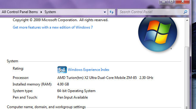

Originally Posted by JaneFancher View Post
Nope. I'm definitely 64 bit OS. Got lots of RAM for graphics and 32 bit can't use it. The ONLY reason I ended up with a Vista machine at all was because my main graphics laptop went belly up this summer and I had to do a fast replacement.
Did you take a look in Control Panel -> System? I'm not saying you're clueless , I'm just saying please check. A screenshot would be very nice.
Valloric is offline   Reply With Quote
Heh heh...no offense taken. Yeah, I'm sure. Been doing this computer thing a long time. Having said this, I now have to figure how to upload a pic to this site. What I am noticing...this was supposed to come with 8GB Ram and it's only showing 4. I'm wondering if I have a dead chip...
