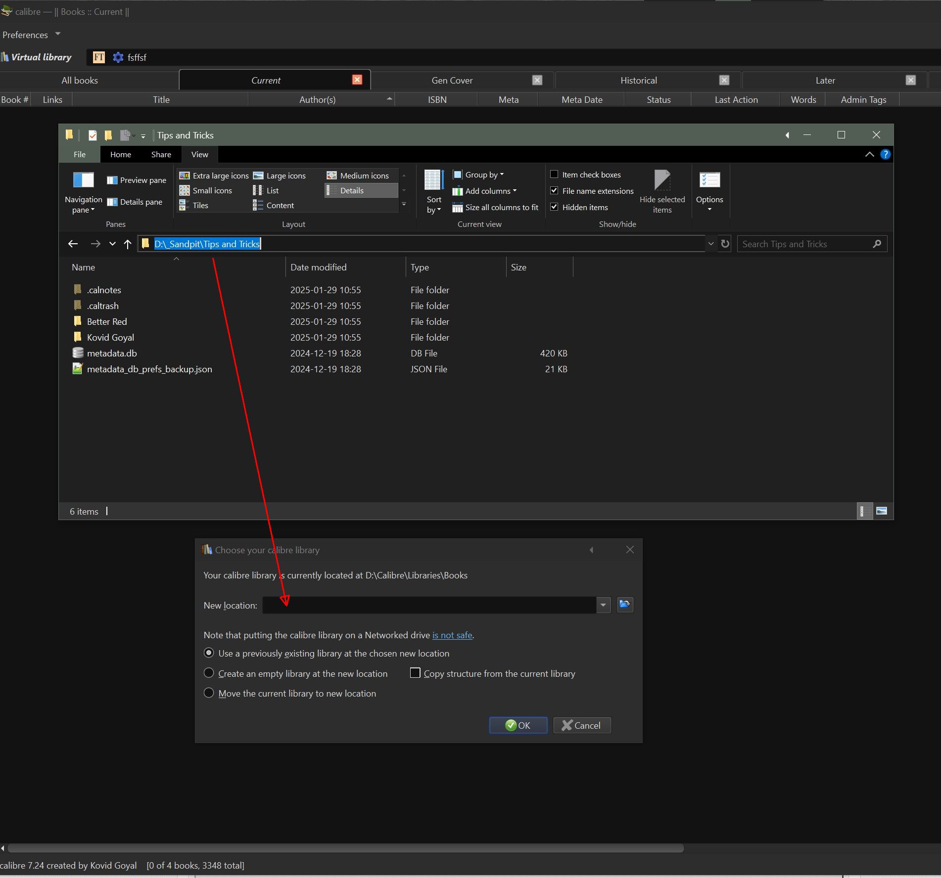

Nope, what you need to do copy the path of the folder that contains the metadata.db and paste that into Switch/create to register the library, viz:
Name:	Screenshot 2025-01-29 105931.jpg
