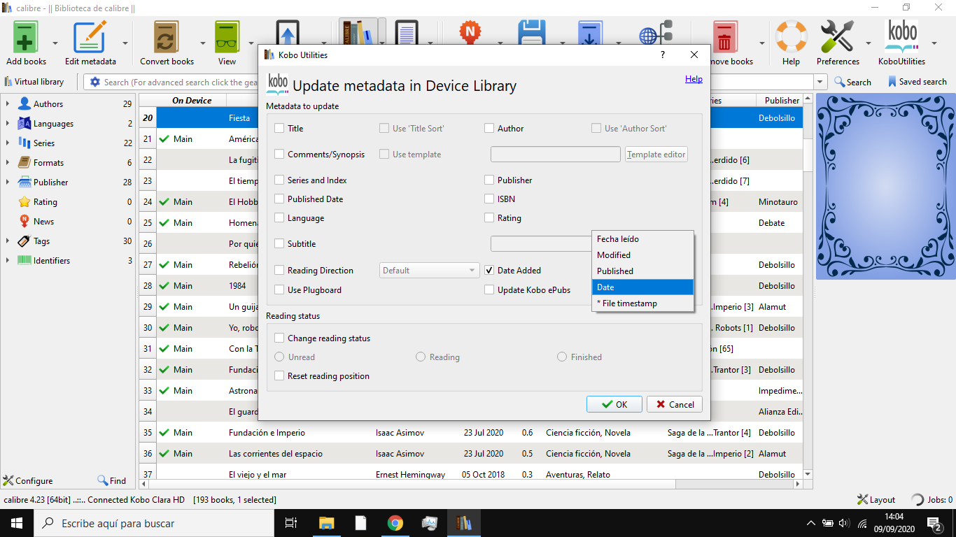

Sorting via recent (date added) doesn't work
Had to delete and transfer all books again from Calibre to device. The problem is now that they all have the same added date, so I can't sort them via recent added.
Is there any way to replace the device added dates with the added to Calibre dates? In this case the sorting via recent added would at least be in the same order as in Calibre.

Firstly, well it does work. The problem is the date used is when the book was imported by the device. Which will be over a short time.
To change it, the Metadata update function in my Kobo Utilities plugin can set it to various dates including the "Date" column in calibre or the Published date. It should be able to use any date column you have in calibre.

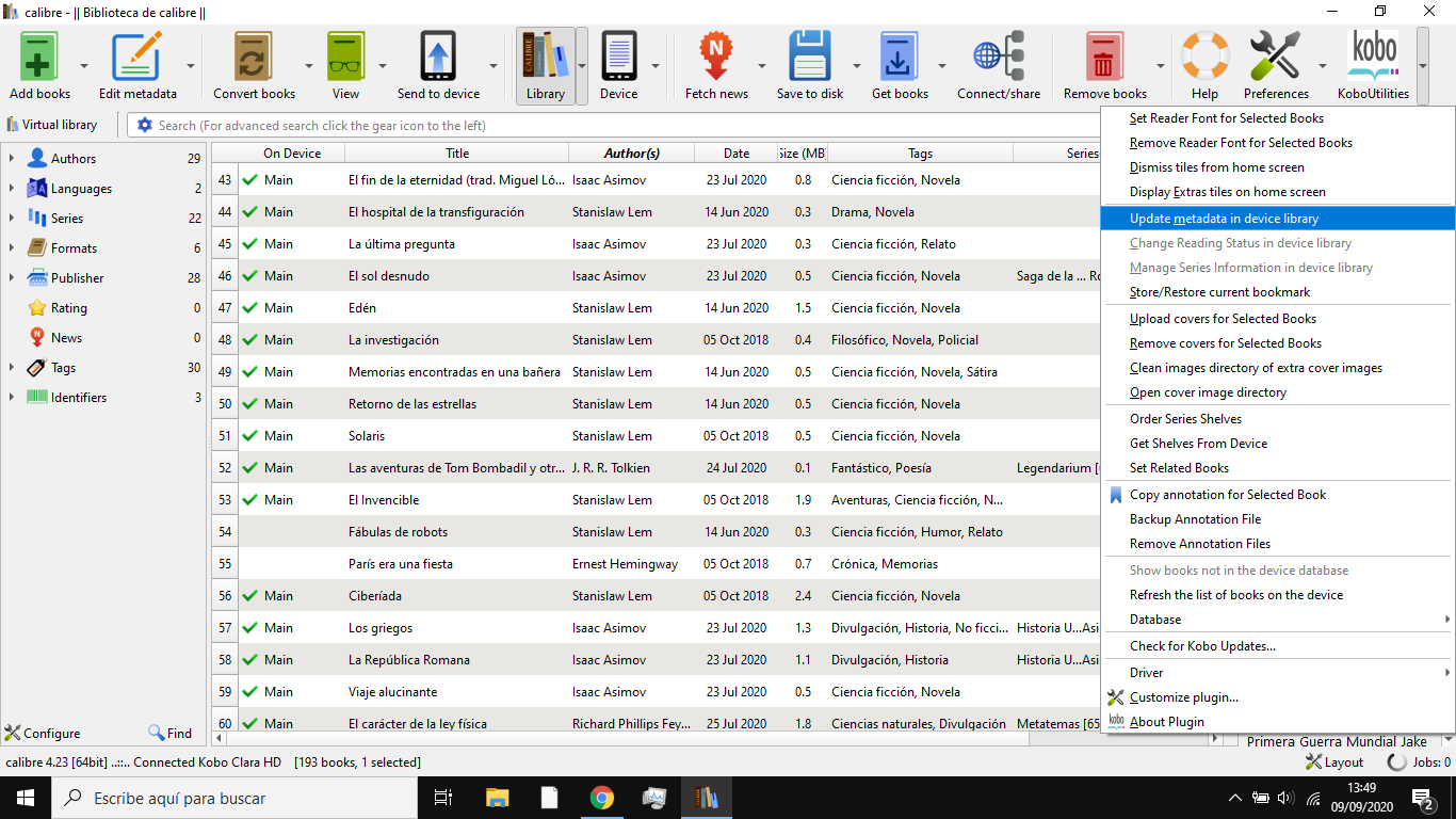

Davidfor provided the right solution to your problem. However, I wanted to provide some screenshots too since the Calibre UI can be not so user-friendly, it's got so many options but knowing where to look for is the first step. First, as stated, you need the KoboTouch plugin. This should be straight, go to "Preferences"->"Plugins"->"Get new plugins", search for kobot utilities and install that plugin. After installing it or if you already have it installed then what you need to do is click the little arrow next to the Kobo Utilities icon to show the drop menu. There you have the option "update metadata in device library". If you are on the "Device" view the option will be greyed out, you have to be on the "Library" view for it to appear clickable and have your device connected. You also must have the books you wish to update selected before clicking it. Clicking "update metadata in device library" opens a new window with the option you are looking for. Check the "Date added" box and select what date field from Calibre you want it to be. In your case you would select "Date", which is the date added to Calibre, but it works with custom columns using dates too. From then on sorting by "Date added" in your kobo device will sort your books according to the parameter you selected, I particularly like setting it to the "published date" so I can have the books in my Clara sorted according to their publication date.

Thanks, davidfor and OneManRevolution.
Worked brilliant
Don't know why, but it looks kind of nice seeing the adding history. Brings memories

Thanks for the step by step instructions, @OneManRevolution. I tried to update the date added metadata in my Kobos before, and wasn't able to find the option, I think the part about staying in the Calibre library and not in the Device library view was the key to my frustrated attempts.

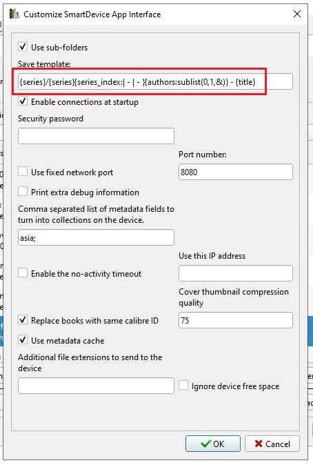

I use Calibre to organize and send books to KOReader wirelessly with a saved template in SmartDevice plugins to arrange them in the KOReader folder
You can set how the book is sorted on KOReader as shown in the attached image.
IMHO, it is easier to organize books on KOReader using Calibre than copy-paste the book to the KOReader folder.

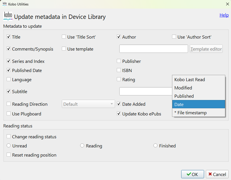

For what it may be worth, when I am setting up a new Kobo, I use the Kobo Utilities plugin's Update Metadata tool to set the Date Added to the calibre date which is when the books were added to calibre. I've used that function since @davidfor added it to Kobo Utilities and it has worked great for me.
