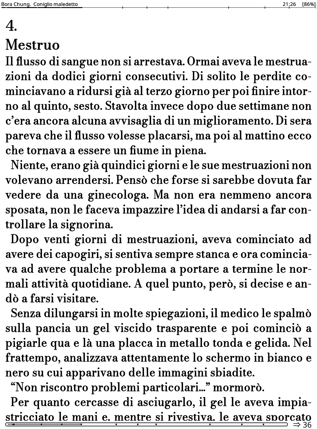

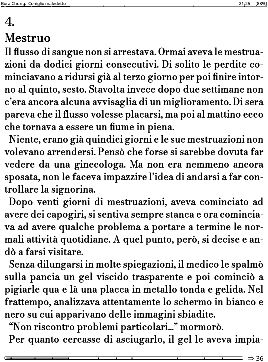

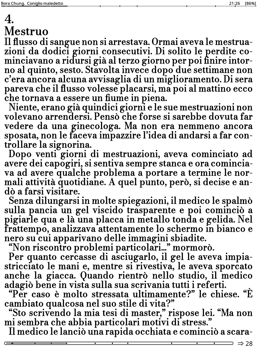

1st page of a chapter with my default settings: Reader_2024-06-05_212542.png
1st page of a chapter with minimum line spacing:Reader_2024-06-05_212613.png
1st page of chapter with minimum vertical margin: Reader_2024-06-05_212653.png
2nd page of a chapter with my default settings: Reader_2024-06-05_212716.png
I'm on a nightly from may (i didn't remember what specific version)
EDIT: updated to latest nightly, now the 1st chapter page is more next to the bottom bar than the other pages

on third image "1st page of chapter with minimum vertical margin" some letters like "p" appear to be cutted
nuovodna is offline   Reply With Quote
Old 06-06-2024, 10:36 AM   #8
Posts: 80,789
Karma: 150249619
That's because the last line ends too close to the reading progress bar. You need to up the space between the last line and the progress bar or just leave it and put up with it. The reason it happens on the first page of the chapter is because the space and the larger lines makes the text end lower on the page. The next page does not have this so ends in a different place. So if you do up the space at the bottom of the page, you could have more space on the next page or lose a line.
