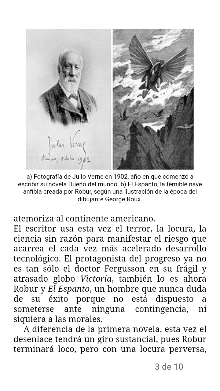

On epub3, the reading experience is very good, even in a small screen. Image and caption are a % of the height viewport (retaining proportions). And by tapping the image (in a good epub3 ereader) the same one will be showing at full screen.
Here you can watch screenshots from Kobo for Android on a 5" screen:
ID:	208331 Click image for larger version

And now one last thing; the three images, must be joined? That is, a break can't be produced between them? Because the code is different is a break is allowed or not. The above code allows a break between the three images (what the above code makes is to maintain the caption joined with the images, but not the three images joined. For the latter, something more is needed.)
