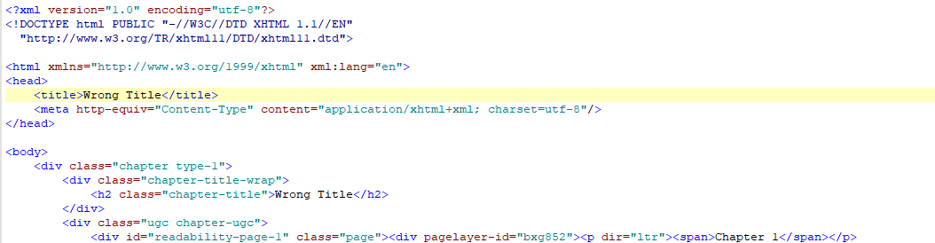

The title is inside <title> </title>
is then repeated again in <h2 class="chapter-title"> </h2>
while the actual title is inside <span> </span>
all of the chapters in the ToC are exactly the same

That is quite the mess.
Your screen shot did not show if the first child div of the body tag ends right after the p with the span tag that holds the actual title.
If so you could use regular expression search for that first child div, capture it, extract the title info, then replace that entire first div (and its children) with a much simpler properly formatted single header all in a single pass.
If instead that first child div encompasses the entire body that approach will not work. Then a multiple pass approach is needed and possibly the need to use the Python Function Replace plugin.
If all the Chapter titles are simply an incrementing series, then just the Python Function Replace plugin may be enough.
That structure is so bad though, you may want to strip all that unneeded dross out and reformat the entire thing.
