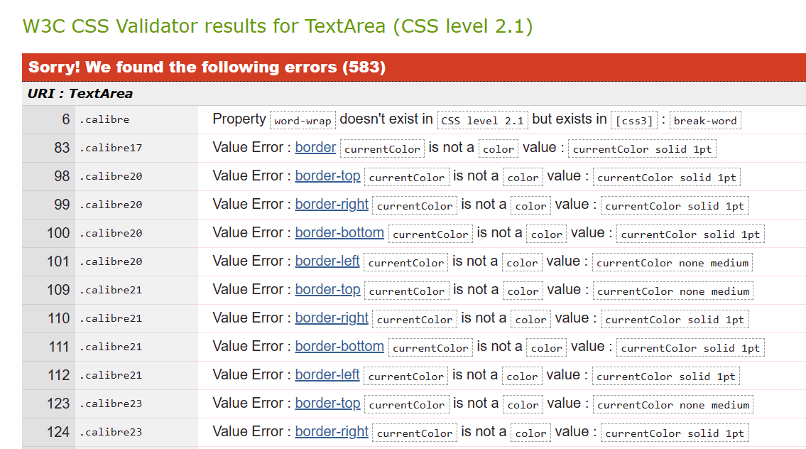

you are probably Right, using Sigil, see image below for error, so how can I fix it now

Looking at that, one issue is that border-style is what you need and that is not well supported in ePub2 (hidden and none work, everything else will display as solid). Since Apple is ePub3, most of the border-style properties should work. A quick and dirty fix might be to use Sigil's Epub3-itizer plugin to convert your ePub to ePub3.

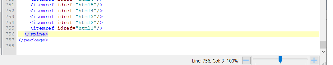

I convert to epub 3 then I got this error, I think if I can fix that, it will probably work
see image
error
FATAL RSC-016 /OEBPS/content.opf
(line 756, col 3) Fatal Error while parsing file: The element type "spine" must be terminated by the matching end-tag "</spine>".
see image for line number pointed to
is there a way to fix that now?

You should find a <metadata ....> section closed by a </metadata>, a <manifest> closed by a </manifest> and a <spine> closed by a </spine>. This error may indicate that either the <spine> is missing or there is more than 1 <spine>.
If you can post the entire content.opf, it would be easier to see what is wrong. You can rename to to .txt and attach it or copy/paste the content (preferably inside [spoiler][code] . . . . [/code][/spoiler].

here is the file, I rename it to .txt, so you can check and let me know
