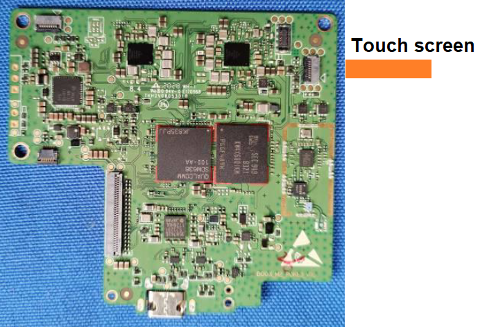

You might try re-seating the connector of the touch.
Open the back, flip the bail up on the connector, remove, re-insert, push the bail down.

Do you have ADB & rooted? Did you try that command?
Opening the case with guitar picks starting near the USB.
The corners are a bit tough to pop.
The flex PCB for touch is covered wtih black fabric tape.
Pick that off. Flip the black bail up with your fingernail.
