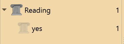

Following your example, the best I seem to be able to do, is to get a custom column in the Tag browser with a child item which is its value and a number of titles that have this value. To get the book there, I need to select the book then start editing metadata, go to user metadata tab and set the user column value there.
Well, didn't expect to be able to drag&drop books, but it would be nice.
So this is the best we can get?

I'm able to drag & drop books into my custom Status category, so it should work - though Calibre is sometimes a bit picky about how you do it, because depending a bit on how you click the book, it can start editing the entry or selecting many. But drag and drop definitively works.

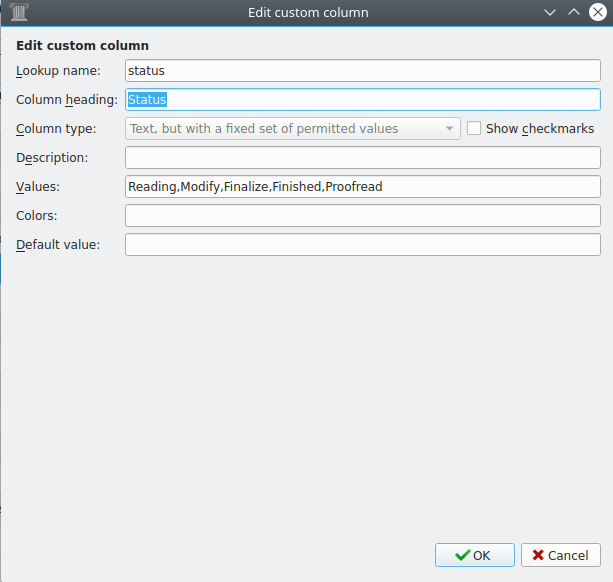

I would suggest you do something like this, and set up the column with values like "reading, abandoned,finished" so you can easily drag a book to "reading" and then when done with it, either to "abandoned" or "finished".

It slipped my mind to mention that in order for the drag and drop to work, you need at least one book in each category so that the category will appear in the sidebar. Since I usually have multiple books at various stages, I didn't think of it. The same applies whether it's a tag, a custom column or whatever - at least one book needs to have that data because the sidebar is basically just filters for the library view. Sorry for the confusion.
