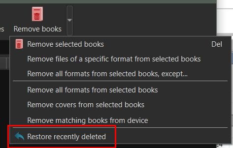

The current version of Calibre has it's own trash. So you can easily restore anything you've deleted. The default time period for auto-delete of the trash is 14-days.
Upgraded to 6.17 and the 'what's new' says there is a button to clear the trash.
I cannot find it and where can can you set the default auto delete.
Thanks
skil-phil is offline   Reply With Quote
Old 04-27-2023, 07:38 AM   #8
Posts: 22,089
Karma: 30277960
Thanks
Name:	Screenshot 2023-04-27 203638.jpg

Thanks BR.
