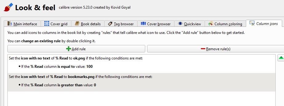

here is my pref under column icons (attached). Can you please walk me through how to do this. I am not good at this programming stuff, thank you!

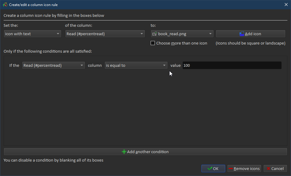

Try these. I'll give you an extra status that comes in very helpful
For read books:
Name:	2023-04-15 22_30_11-Create_edit a column icon rule.png

You may want to set "icon without text" instead. The percent-read will still be available via tooltip.

It is asking for an icon?
I don't remember setting an icon for the other 2 I have in there. On the column it just has the number 100 in read. How can I make it the same? (see attach)
