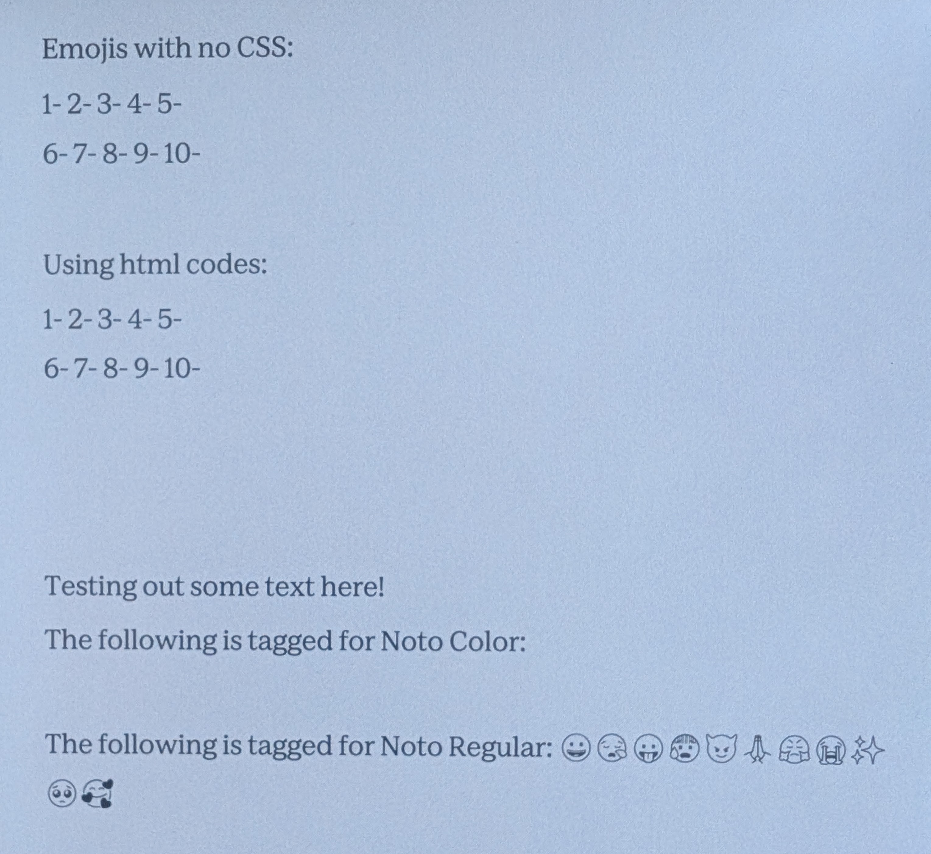

And how it appears on my Kobo:
Happy to have this working for now. I will go through the main text and set it up the same way so it will display emojis where they occur.

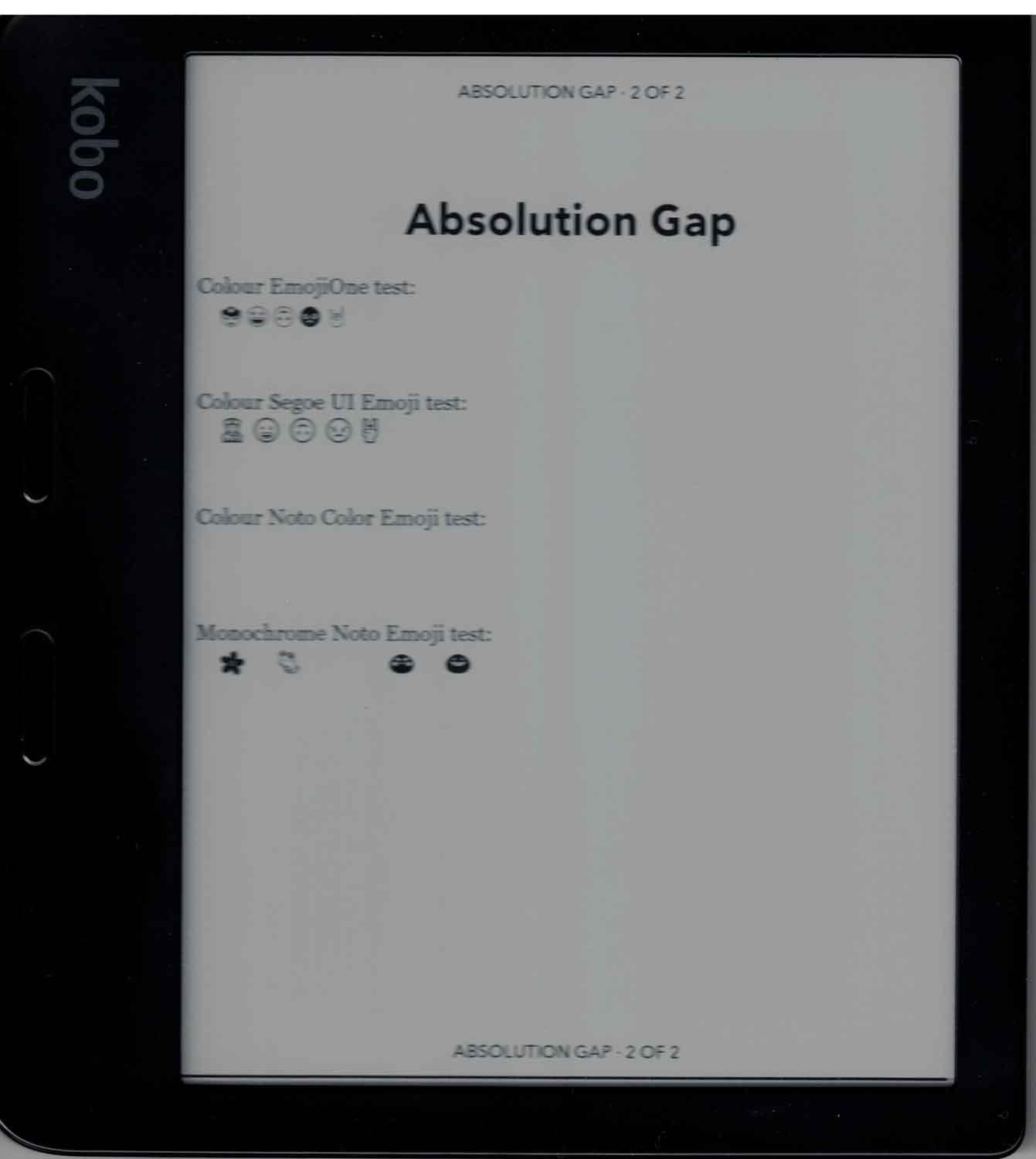

I've played around with this for the last half an hour and, like you, I was unable to render the colour emoji's.
I re-downloaded the font file from google fonts, in case your copy was corrupt. No luck, still did not display.
I then changed to a different colour font file.
I tried this one... https://github.com/adobe-fonts/emoji...jiOneColor.otf
And then also used Segoe UI Emoji from Windows.
Both of these worked, but not the noto colour file. No idea why that particular font file won't work.
I've attached my epub if you want to check it out.

Old 10-10-2024, 10:50 PM   #12
star-soup
star-soup began at the beginning.
Posts: 10
Join Date: Aug 2024
Device: Kobo Libra Colour
Thanks for sharing the epub! Been using it for further testing.
Currently that Segoe UI Emoji font has provided the best overall solution. I loaded it into the main fonts folder on my Kobo, and then selected it as the main font for the whole book. The text is readable and all the emojis render! They show up black and white despite rendering in color when I open the same book in Calibre, but the important part is that they show up and I don't have to go through the entire text to tag each instance of an emoji showing up.
I'll keep messing with this in the future but I'm very glad to have the Segoe font as a solid and functional option. Thanks for mentioning it!
