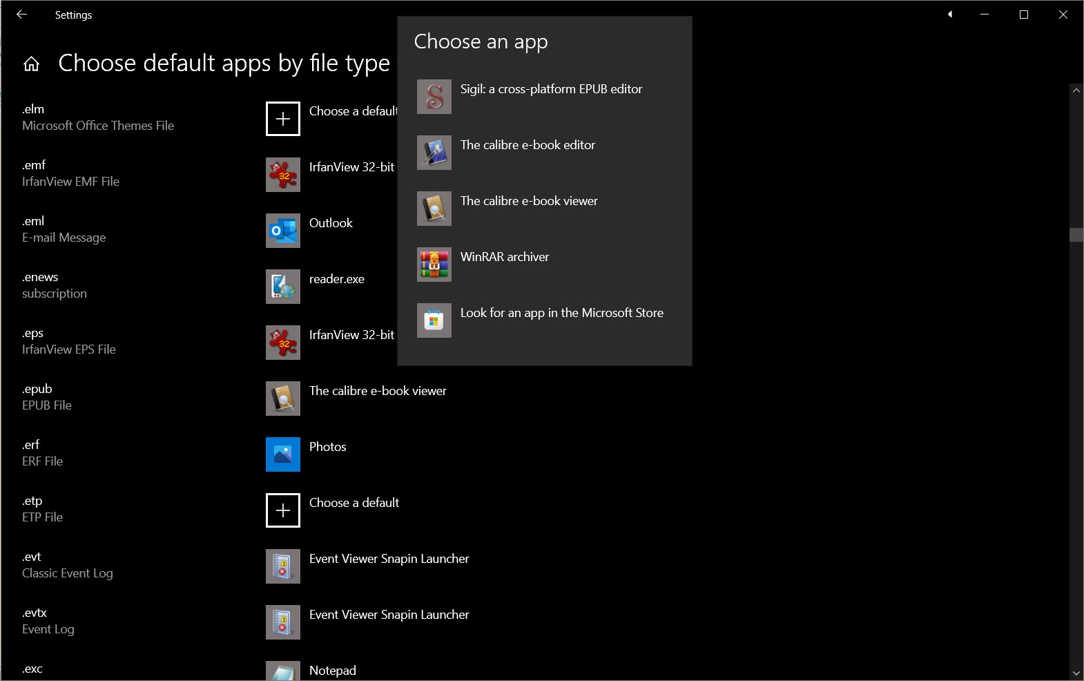

Long shot - what is the .epub default program in Windows Settings
Name:	Screenshot 2022-08-15 090945.jpg
