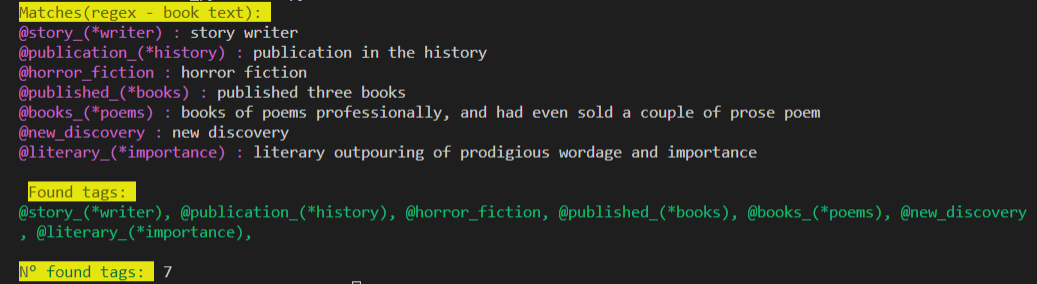

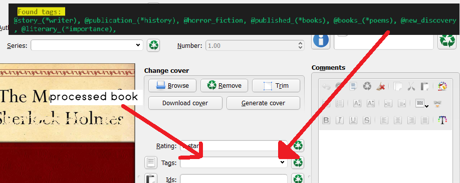

Extract text from selected books, convert them to tags, and add them to metadata.
I created a python code in VScode that allows me to perform text searches within an epub book, these searches consist of matching the text of the book with regular expressions. These regular expressions come from patterns that I formulated for the tags in my library. I have already managed to get over 400 tags this way and I have a custom column for them, I add the @ symbol at the beginning to differentiate them from tags downloaded from other sources. I have 3000+ books and I want each of them to be attacked by these 400+ regular expressions.
I need help because my code only contemplates the search in a single book and what I want to configure is:
** Run the code on selected books from my library (books_ids).
** Found tags are added to the metadata.
** Add a verification tag confirming that the book was processed.
The truth is that my knowledge of python is very poor, I only learned about regular expressions thanks to Calibre.

print('\n\n' + colorama.Back.YELLOW + "N° found tags:",colorama.Style.RESET_ALL, len(temp))
I show you in images, what I need to execute.
I'ld appreciate any help with the code, thank you very much.
