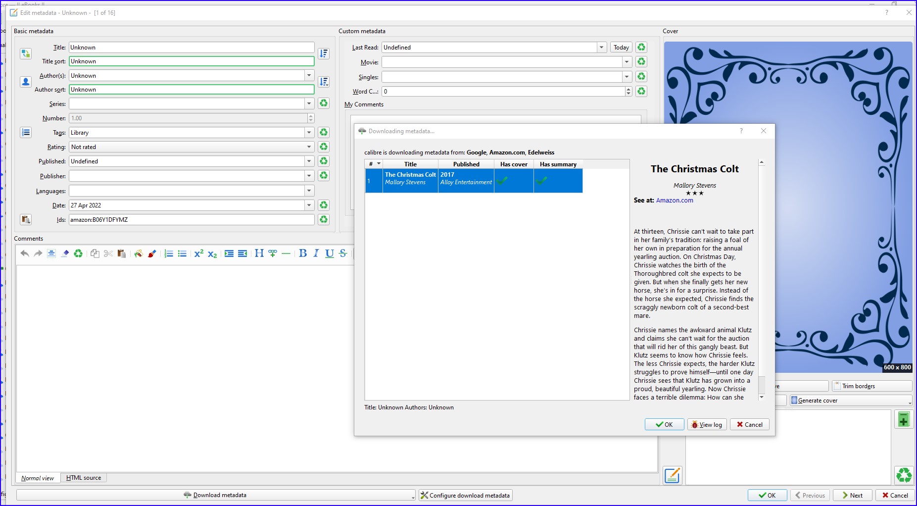

It works for me here. But I used amazon:B06Y1DFYMZ
When I used mobi-asin:B06Y1DFYMZ it failed
