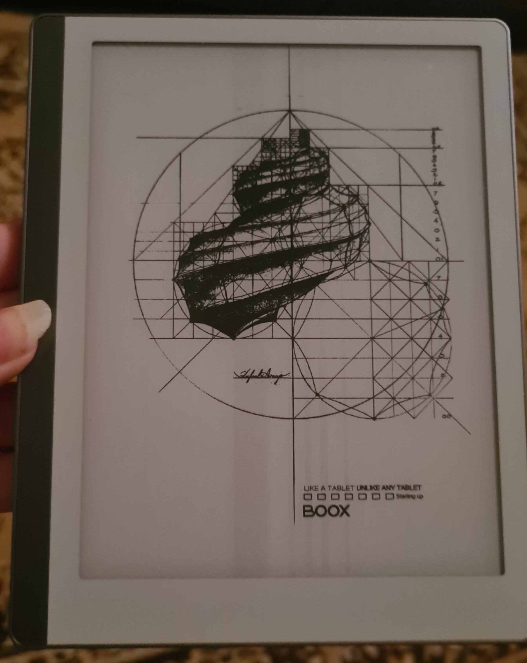

Bricked Leaf. Factory Reset, Wipe cache still in bootloop. Can't flash firmware?
Hi,
I bricked my Leaf. Badly. My fault, I'm so obsessed with getting OTG SD cards to work fully in all apps that I want them to with root that I've changed storage permissions in packages.xml (and other places) that I probably should not have.
I did systemless root via Magisk though I don't know if I broke that with permission modes I did get into system/etc/ today in frustration. Prolly. Root was working prior to that though.
I can get to recovery, I've done multiple Wipe Data/Factory resets and multiple Wipe cache but no. Still in bootloop, just this time it reverts back to Chinese language instead of English, trying to start setup...I get to the pick language menu for a couple of seconds and then it just falls back into bootloop (subsequent loops we don't even get to that menu it cuts out too quick).
Sometimes it then gives me an error screen after awhile telling me it failed, I need to factory reset which I do and then we're bootlooping again.
My computer can't read the device. ADB won't recognise there's a device. Reboot to bootloader via recovery I can't access anything though to be honest I have no idea what I should be doing there/typing anyway. fastboot devices returns ???????????? devices.
I've been looking at the Poke 3 Soft Brick thread...I'm not following it well plus I'm not sure I even have access to fastboot either. Typing some of the commands I saw in that thread just leave me with "waiting for any device".
I do have update.upx, update.zip and patched magisk boot.img on PC. I also have the Onyx card reader and FAT32 USBs at the ready. I do not have a recovery.img though and limited info on the Leaf as it's such a new device.
There's no options on their recovery to select a zip or storage to restore from there either like I'm used to (though that could be TWRP...I've not had to root in nearly 6 years so I've not gone near a stock or TWRP recovery in 6 years).
I can't see how I'm going to even get anything to fix/restore with no "update from zip" or adb or fastboot . I need a Download mode or Odin lol.
I do have the case so the buttons at my disposal are volume up and down and power.
I'm so bummed out and I don't have the technical knowledge to work this out on my own.
Thanks for any help.

One thing I just noticed is that maybe I'm getting into EDL 900E mode though I don't know what that does. I just saw it on the tutorial I used to root with Magisk (it's probably the one most people use Thomas' Random Hackery). It does appear in Device Manager when plugged in in that mode as QUSB_BULK_SN:015B9110 with a little yellow ! icon like when your driver isn't right though I don't know if that is relevant/useful. I've seen talk of installing Qualcomm/Snapdragon thing I just didn't think that was relevant. Would that be a help?

I'm very nervous about breaking it open. It's going to be real difficult (broken two fingernails so far lol) I think I will leave that as last resort for now if all else fails I'll have to razorblade it.
I have found a cable with good reviews that will get here by early April to see if that might be an option too.
In the meantime RE: fastboot, what commands can you recommend me test here? My minimal adb and fastboot was a bit outdated it was returning me two devices, device and emulator which was making running the commends to root difficult even with -d so I upgraded using 15 second ADB and updated drivers. They all appear to be up-to-date. I also used fastboot fine to test if my patched boot.img worked and then again to flash it permanently.
fastboot devices command is the only thing that "works", as said it returns ???????????? device. Not that I've tried to type much else because I don't understand what I'm supposed to be doing there anyway. I read one of your posts you linked to via Poke 3 Softbrick but I don't even know what a fresh fastboot boot recovery is. I got a bad feeling it's not going to like the commands.
I must have really messed up system. I went crazy in there with storage permissions tinkering not really knowing what I was doing. I'm used to bricking devices but being able to fix them lol.

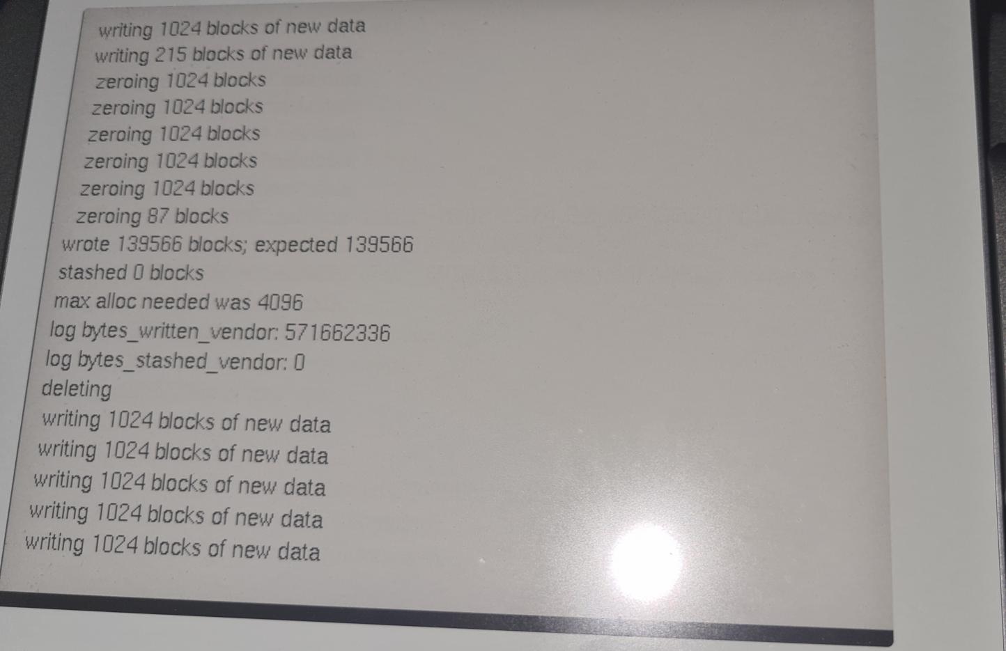

Ok, here is an interim test: Check your PMs for the download link.
C:\>fastboot boot rec.img
What you are looking for: Device reboots, "Onyx" splash goes to all white screen, ADB @ 18d1/4ee7 goes "bong".
C:\>adb devices
C:\>adb shell
# id
# getenforce
# start ttyscreen
In the meantime, can you get the first couple of lines (those with "getprop") out of META-INF/com/google/android/updater-script out of your zip? Just post as plain text here, please.

Not sure about the "bong" part, but I executed the commands and now I have the white screen with "ttyscreen started" on it.
Edit: Oh I should say what adb said to me back too I guess:
adb devices gave: 37C9AA46 recovery
C:\adb>adb shell
# id
uid=0(root) gid=0(root) groups=0(root) context=u:r:su:s0
# getenforce
Permissive
# start ttyscreen

Yeah, you've got rooted, permissive ADB in a recovery. What more in life could you want?
Ok, download a new rec.img from the same link you had.
Do the following commands:
C:\>adb push update.zip /data
If that doesn't go to 100% we'll have to do it differently.
C:\>adb shell
# mount -t ext4 /dev/block/bootdevice/by-name/cache /cache
# /sbin/update-binary 2 1 /data/update.zip
Then cross your fingers. When/if it stops nicely:
# setprop sys.powerctl reboot
Renate is online now   Reply With Quote

Not having much luck sadly. It's probably me being an idiot.
From stock recovery > bootloader > fastboot boot rec.img
C:\adb>adb push update.zip /data
adb: error: failed to read copy response
update.zip: 1 file pushed, 0 skipped. 20.2 MB/s (1370512644 bytes in 64.628s)
that lost me adb:
C:\adb>adb shell

Ok, it looks like you have no room. I was trying to do things the easy way.
Err, one thing to check first:
# ls -l /dev/block
Are you seeing lots of "mmcblk0p??" or lots of "sda??"
If you are seeing lots of sda?? just tell me and stop for now.
Only if you are seeing lots of mmcblk0p?? can you try this.
Do you have a Type C OTG adapter? Or a Type C flash drive?
Stick your update.zip on a flash drive in the \ directory.
First, fresh fastboot boot rec.img
Wait until the screen goes white.
# start ttyscreen
# start autoupdate
Then, when it says, plug in your flash drive and cross your fingers.
Keep a camera ready for error messages.

Yes I got mmcblk0p.
Ran the whole thing. It excecated for quite awhile, lots of writing in 1024's, the progress bar ran through once all black, then it started a second process streaming along with a second progress bar in black .Now we've stopped at this screen for quite some time now and it's doing nothing more.
I don't know if that's it and now I'll have to send a command to reboot or if it's just frozen. The progress bar does look all finished (second time around). Everything else is gibberish to me lol.
Name:	Untitled picture.jpg
bazookajoe is offline   Reply With Quote
