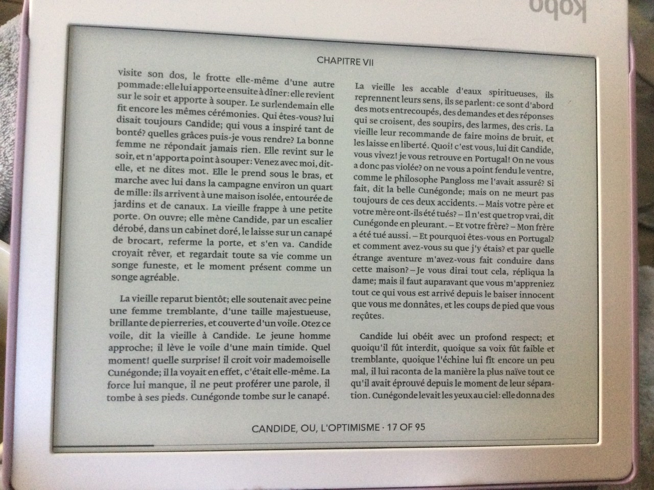

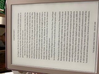

I thought I had fixed my problems with these by using the readerAdobewidow=1 etc config file amendments.
It doesn’t seem to make any difference though, and I have been going in editing it again and resaving.
The last time I did it I ended up with this ludicrous last page fail.
Can anyone tell me why it seems to have made this ePub a lot worse than before?
ETA: I had to shrink the photos till they were tiny before it would accept the upload. I know they are poor quality.
I really want to be able to read some books as epubs so this has been disappointing.

Sorry but I can't see why you are complaining when you are getting exactly what you asked for. The last page has one line because widows was set to 1 which allowed that to happen. If you had set widows to 2, you would end up two lines on that last page but a wider gap at the bottom of the second to last page.

David, surely that last line should have been retained on the previous page; it looks like there was more than enough room for it. A widow setting of "1" ALLOWS one-line widows, IF NECESSARY; it shouldn't force them when it's not.

There is so much space at the bottom of the page! Enough for multiple lines.

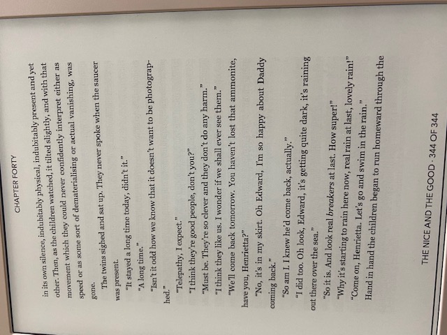

I’m getting exactly what I didn’t ask for!
Here is the third last page, which has the lines perfectly to the bottom.

All too often, what looks like sufficient space to my eyeballs is not seen as sufficient space by the renderer. I've noticed that on my computer with multiple ebook softwares (Adobe ADE, Thorium, Kindle 4 PC, etc.) and on Kobo, Kindle, Tolino, Sony, etc. ereaders.
Reducing the builtin padding at the bottom of the page, changing line height, etc. can help. On occasion, I've also removed the blank lines at the end of a chapter that some authoring software and/or authors seem to have an unnatural love for.
Yeah, I was thinking that it could be the same. Is that empty space otherwise filled with a line of text when there are not windows/orphans involved?

Yes, it is - please see the pic I posted above of the third last page in the book to see what the pages normally look like.
