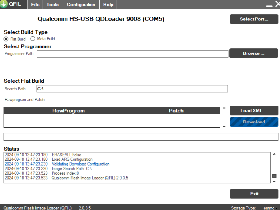

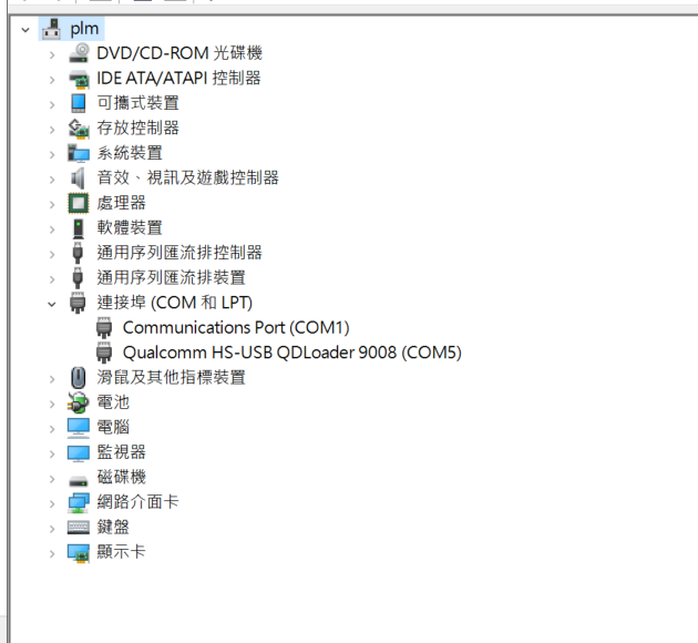

![]() Posts: 41
Join Date: Sep 2024
Device: Boox Note 3
| Advert | |
#6 |
![]() Posts: 41
Join Date: Sep 2024
Device: Boox Note 3
Is this edl mode?[/QUOTE]

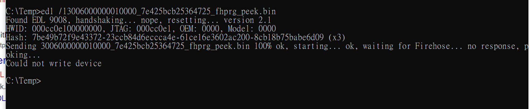

![]() Posts: 41
Join Date: Sep 2024
Device: Boox Note 3
I found another thread (EDL on a Boox Note3) mation
sdm660/3006000000010000_7e425bcb25364725_fhprg_peek.bin worked on Note3 but in my machine got the error below C:\Temp>edl /l Found EDL 9008, handshaking... version 2.1 HWID: 000cc0e100000000, JTAG: 000cc0e1, OEM: 0000, Model: 0000 Hash: 7be49b72f9e43372-23ccb84d6eccca4e-61ce16e3602ac200-8cb18b75babe6d09 (x3) C:\Temp>edl /lbkerler\qualcomm\factory\sdm660\3006000000010000_ 7e425bcb25364725_fhprg_peek.bin Found EDL 9008, handshaking... nope, resetting... version 2.1 HWID: 000cc0e100000000, JTAG: 000cc0e1, OEM: 0000, Model: 0000 Hash: 7be49b72f9e43372-23ccb84d6eccca4e-61ce16e3602ac200-8cb18b75babe6d09 (x3) Sending 3006000000010000_7e425bcb25364725_fhprg_peek.bin 100% ok, starting... ok, waiting for Firehose... no response, poking... Could not write device I can load other .bin such as bkerler\qualcomm\factory\sdm636\000cc0e100000000_7 be49b72f9e43372_fhprg_bqx2_peek.bin What's the problem? another I don't know why my post always dispear after reply |
#15 |
Onyx-maniac
![]() ![]() ![]() ![]() ![]() ![]() ![]() ![]() ![]() ![]() ![]() Posts: 4,151
Karma: 18764971
For most devices you have to pay attention to the PK hash and it must match.
That's because it's the security mechanism for Secure Boot. But if you don't have Secure Boot enabled the universe of loaders to check is much larger. A single loader can support multiple different processors. In the final analysis the loader you need is the one that works. The loader you mentioned in #12 seemed to work fine, but you need that /u flag. Why are you talking about a different loader in #14? |
