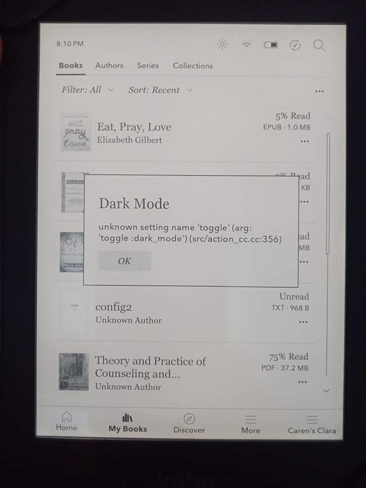

What seems to be the problem on my friend's Clra HD. Darkmode throws this error.
That looks like an error from NickelMenu. Either they have the wrong version of NickelMenu or they have an error in the configuration.

You have the wrong version of NickelMenu on that device. See the link to the correct version, and full instructions on using dark mode, here:
https://www.mobileread.com/forums/sh...98&postcount=1

THank you. It turned out, she was indeed using the wrong version of Nickel Menu.
