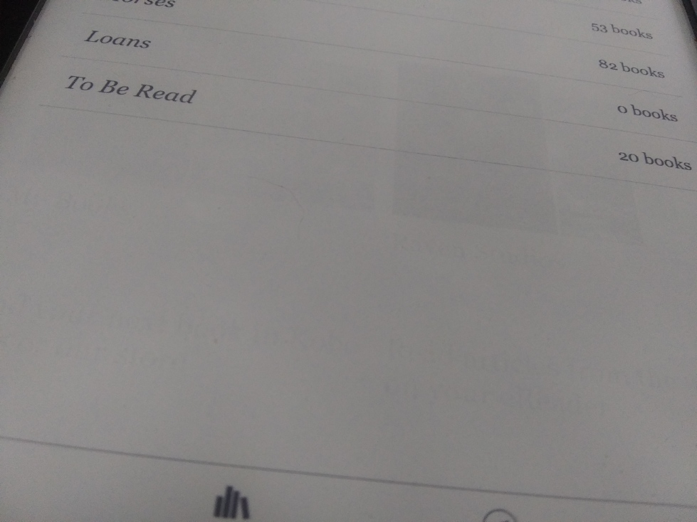

A new question:
I borrowed a book from Overdrive and used Adobe Digital Editions to load it onto my Kobo. Then I created a book record for it in Calibre and matched it and put "Loans" in #kobocoll. the matching works; the metadata got updated and it's fetching my Kobo bookmarks. But for some reason #kobocoll won't change the collections.
What did I do wrong this time? The only thing I can think of different from other books (sideloaded or not-sideloaded) is that for library book I only have a dummy .OVERDRIVE file rather than an actual ePub file in Calibre, but I can't see how that matters if it's matched.

But after disconnecting:

While plugged in:
Attachment 186953
That doesn't really say anything about what is on the device. That is what is in your library. You need to look at the device list and see what is under the collections column for the book.
Attachment 186954
I don't know what has happened. It should set the collections even when there is not format. I have just tested this with no problems.
Did the "Loans" collection already exist on the device? Is it in the ignore collections setting of the driver? Is there a change after another connection?
If you it doesn't appear, run calibre in debug mode and post the log. I should be able to see what is happening.

Oh, I put Loans in "ignore collections" to prevent it getting deleted when there weren't any books in there.
I'll remove it. Actually now that I have the square-brackets trick to prevent my "send to device" showing up at all I can just disable "delete empty collections" entirely.
