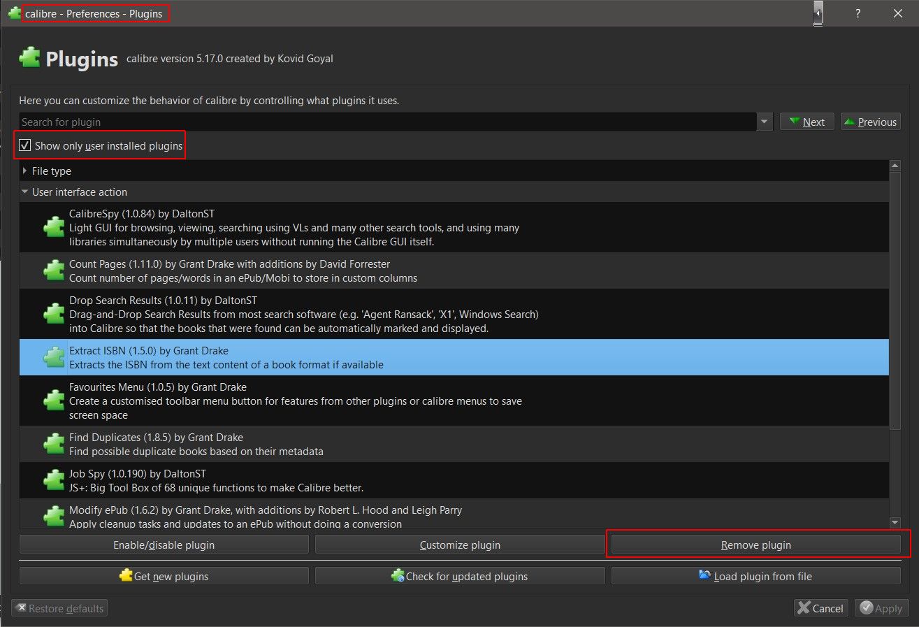

I tried using Epub3 formatting for the three books just now but that does not help. I think there is a bug in EpubMerge, so I want to uninstall it from Calibre and reinstall to see if that fixes it. I cannot see how to uninstall it. Can you help with this?
pipnid is offline   Reply With Quote
Old 05-03-2021, 05:42 PM   #4
Posts: 22,630
Karma: 33008394
Like this (except you'd select the ePUBMerge plugin):
Name:	Screenshot 2021-05-04 073457.jpg
