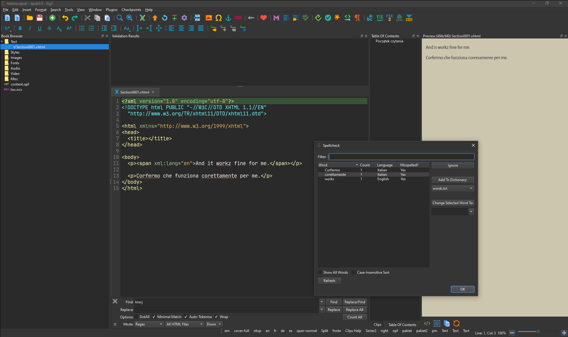

Hmmm…
Don't you have a language declared in an HTML or BODY tag?
Check my test file.

I just tested Becky's book, and it works fine with the latest Italian LibreOffice Hunspell dictionary.
Here's what I see when I select English as the primary dictionary and Italian as the secondary dictionary.

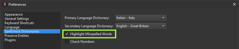

Additional idea: if the misspelled words are not highlighted, maybe you don't have the highlight option enabled?

It is not necessary. Check, for example, such a code:
<p>It is not neccesary.</p>
Suggestions for the misspelled word will come from both dictionaries.
