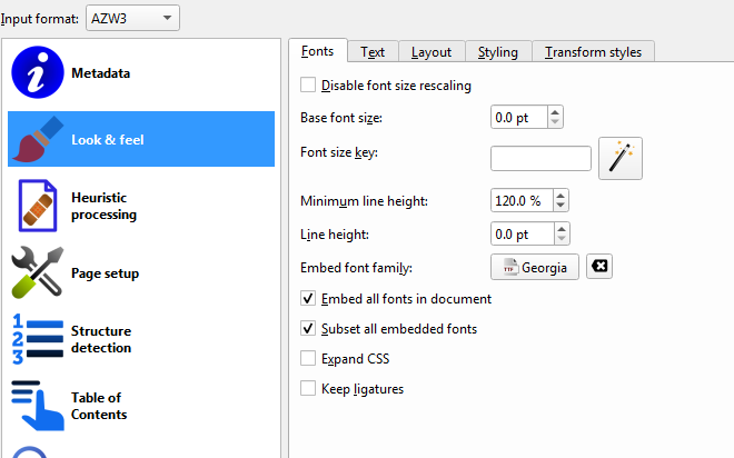

Then there must be something wrong with the way I'm doing it, because the converted PDF only has Arial as its embedded font which is quite different than what is specified in the stylesheet, and as a result the PDF looks very different compared to the original AZW3.
I currently specify the font family under "Look & feel" manually to get the PDF to look like the original file.
Is this the default behaviour or should I enable it somewhere?
