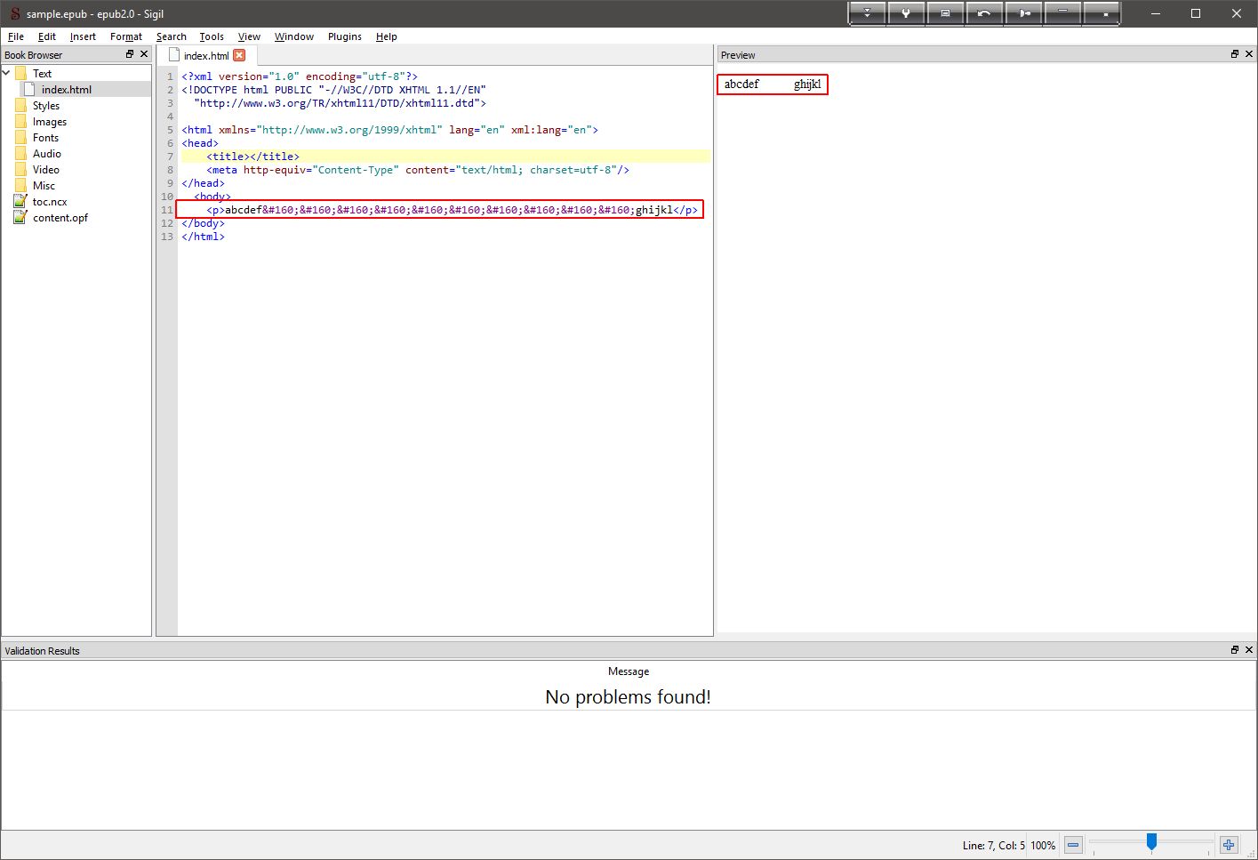

Probably, but for a quick and dirty solution in Sigil I would have something like this (which is more or less what GrannyGrump suggested on Post#2).
I forget how to type and display things like non-breaking spaces, shys, etc in the calibre code editor, which is one of the reasons I don't use it much for editing the code.
