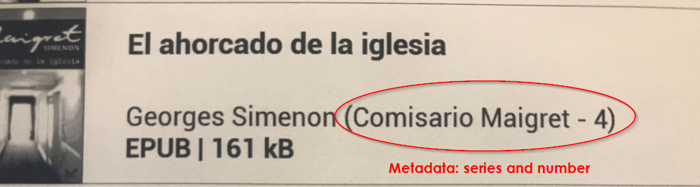

When editing metadata fields "series" and "number" in epub files the only way I get to transfer them correctly to my InkPad 3 is to convert file to epub again once those metadata are set and then transfer new file into InkPad.
The result is OK as you can see below

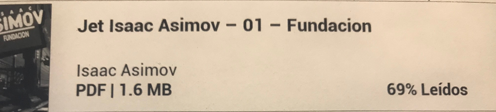

I am using an alternative solution through Metadata plugboard with this expression: {series}{series_index:0>2s| – | – }{title}
So data are displayed like this:
But I would really like to be able to display complete metadata in pdf files under title row as in attached epub example. How can I achieve this?
