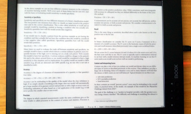

Old 07-17-2017, 09:02 PM   #6
mdp
Posts: 1,481
Karma: 9010563
Join Date: Jul 2013
Example

Old 07-26-2017, 09:07 AM   #8
mdp
Posts: 1,481
Karma: 9010563
Join Date: Jul 2013
Originally Posted by mdp View Post
Note: I believe that at first install, one should change the background to solid white (menu → Settings → Colors & wallpapers) - the default is some tiled image which makes the background grainy. Also: do not forget to install your favourite font (menu → Settings → Directories ; menu → Settings → Text); to try the "two column view" (menu → Settings → Appearance); to set your styles, margins etc.
...and of course, disable the animations (under "Page turning").
I am notified of a strange behaviour: does it run full-screen on yours (some user cannot achieve full-screen)? It should (cpr. the screenshot).
