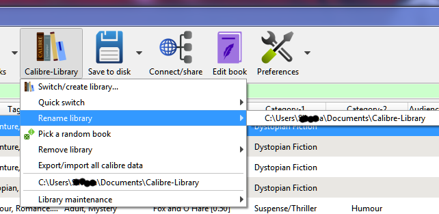

The 'switch to' option ... what exactly do you expect me to do with it? According to that option, my current library IS 'Calibre-Library' and it doesn't have an option to switch to 'Calibre Library'. In fact, the only indication that there are two libraries is the fact that they exist in my directory.
So if I cannot rename the current library, I cannot rename anything as that option simply doesn't exist. Nor can I switch to anything, nor can I delete anything other than 'Calibre-Library'. The default 'Calibre Library' simply does not show up.
(See pics).

@Smokva - your screen shot's indicate you have two libraries with the name "Calibre-Library", I think that can only happen if they are in different locations. I suspect this is contributing to your difficulties.
The one available in Quick Switch and Rename is located at "C\:Users\<whatever>\Documents\Calibre-Library\"

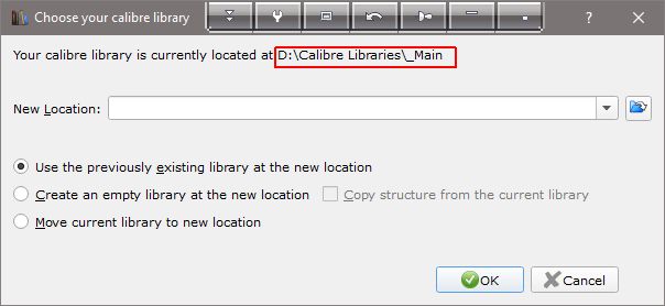

You can find out where the other one is located by going into Switch/create library...

Or maybe one of them has a regular 'hyphen', and the other one has something else (en dash, zero width joiner ??)
