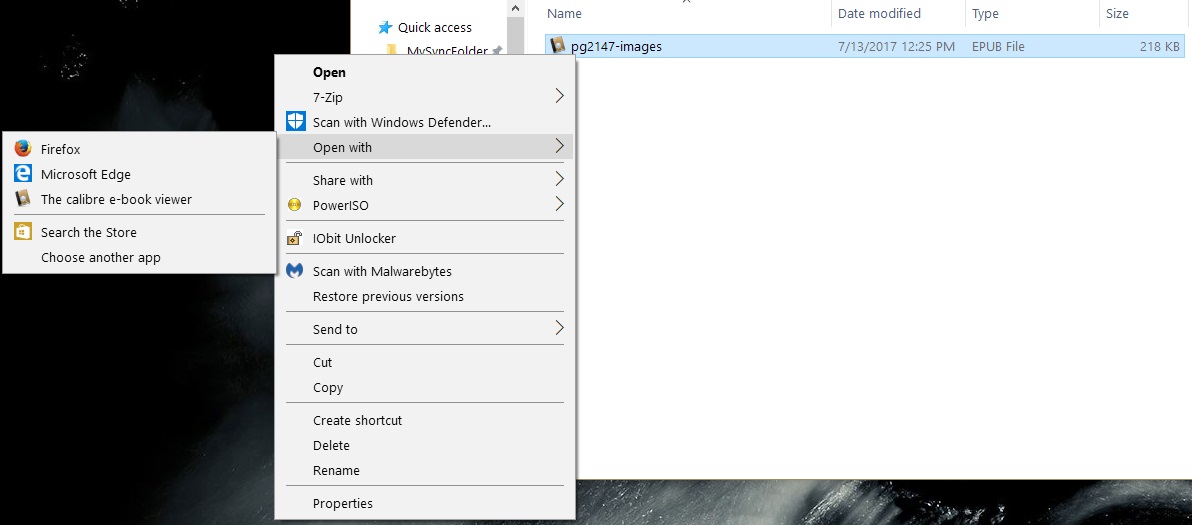

Hello everyone,
Since upgrading to Calibre 3.3, I've noticed that I no longer have the option to right-click on an .epub file and select the option to "Open with" what is called "The main calibre program" in Windows 10 64-bit. [See 1st picture.]
Usually this is not a problem since "The calibre e-book viewer" default program is what I need. However, when I need to convert an .epub for my Kindle 3, I can no longer select "The main calibre program" from "Open with" after right-clicking. Either I must add the book from the main program, or I have to constantly "Choose another app" and select "The main calibre program" since Windows 10 does not remember my choice.

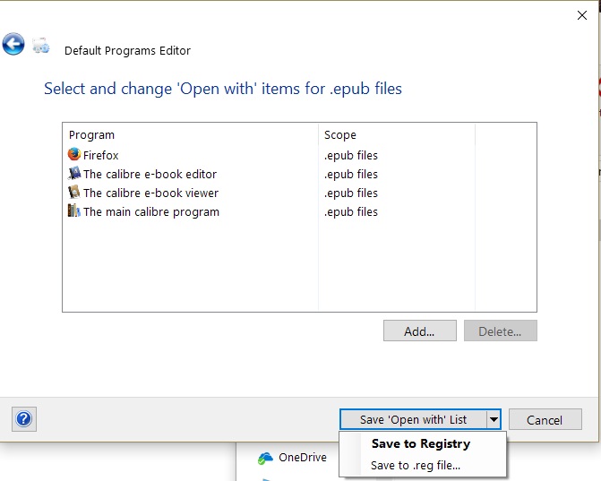

I have tried using the Default Programs Editor program to add "The main calibre program" to the "Open with" selections. [See 2nd picture.] However, despite it appearing among the "Open with" selections already, it still does not appear after right-clicking back in Windows Explorer.
I also tried using CCleaner following a suggestion from elsewhere to clean the registry, but that did not work either.

@yathribjr - workaround: put a shortcut to calibre.exe in shell:sendto and use it rather than windows shell open with option. I use it to add new books - irrespective of file type.
Also see these these items in the calibre user Manual ==>> CALIBRE_NO_DEFAULT_PROGRAMS environment variable and calibre-debug --default-programs option.

Thanks BR, this works like a charm!
These sorts of mysteries make Windows challenging for non-experts like me.
I hope the Calibre folks can look into whether there is something that can be done about this quirk if I'm not the only one experiencing it.

The Windows file association mechanisms have been a rats nest ever since... and IMO the more they try to 'fix' it the worse it gets.
I had all sorts of problems when the change to register calibre.exe as a candidate handler for all 'ebook' extensions was implemented in version 2.20.
I have files with 'ebook' extensions, which are not ebooks, that have no default handler - a conscious decision on my part. So, when the calibre 2.20 install nominated calibre.exe as a candidate handler for these extensions Windows promptly made it the default handler Ψ²
Because I was already using Send To to add books I had no interest in having calibre.exe as a candidate handler for anything, let alone the default handler. So I used the calibre-debug --default-programs unregister option to remove calibre.exe from Windows Default Programs list, and I set CALIBRE_NO_DEFAULT_PROGRAMS to 1 to prevent calibre from automatically registering the filetypes it is capable of handling with Windows.
Now, if I should ever need to, I can add calibre.exe to the Open With list for a specific file extension manually - to date I've not had the need. But I just tested doing it again (Win10 Pro version 1611 64bit) and it works as expected.
