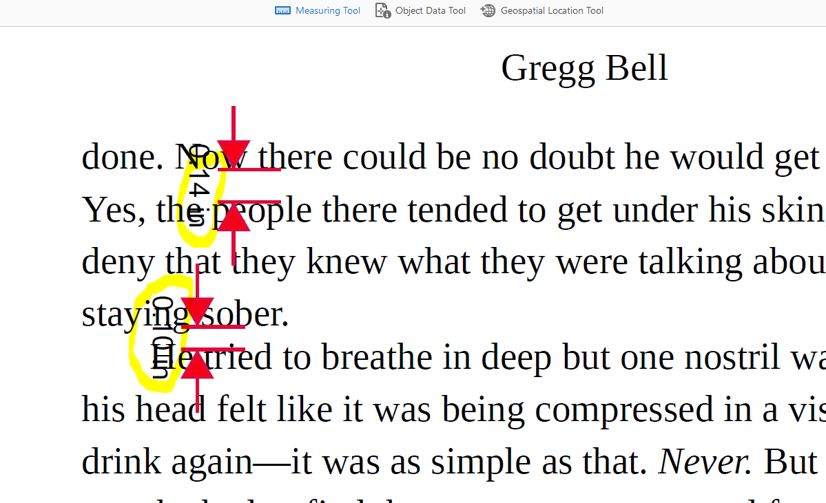

can the source file change line spacing in final epub?
I normally make my books starting with LibreOffice in the 'text body' "style" and the file is .odt. Then in LibreOffice I turn the .odt into an .html. Then I clean up the .html in the text editor Kate. Then I import the .html file into Sigil, where I make the epub.
Well, in order to make the paperback in Createspace I (in LibreOffice) exported the .odt into a pdf. Well, it turns out the line spacing is all funky. Espeically a little extra space between the first and second lines of every paragraph. The Createspace person send me a screenshot. (attached)
Then (mildly freaking) I turned my .odt into a .docx (in LibreOffice) and opened the .docx in Word 2010. The line spacing was normal.
But (back to the Sigil-made epubs) that got me wondering if using LibreOffice to make the .odt was throwing my line spacing off for the .epub too. Now I have stared at my Kindle till I don't even know what the heck I'm seeing and the spacing if not perfect, is pretty darn close to being right, but my question is, considering my work flow (as in the first paragraph) to make the .epub the way I do, is it possible that the line spacing could be goofy in the finished .epub (and hence the eBook as well)?
And then another question. If I have to, and I turn the .odt to a .docx in LibreOffice and I open the .docx in Word 2010 and I go to turn it into an .html there, do I choose "Single File Web Page" or "Web Page" or "Web Page, Filtered"?

Thanks, Jon, but I'm making everything from an .odt in LO. I had nothing to do with Word until I saw that the .pdf I made from the .odt was screwy.
And there's no line height stuff in my CSS.
I don't know, but I don't see how the spacing between lines that might exist in LO can exist in the epub once it goes to .html and gets cleaned up.
But the fact of the matter is the .pdf was goofy. Everybody touts how great LO is at making .pdfs but that hasn't been my experience.

Thanks a lot, Red. I was thinking of doing something along those lines but then, like you were saying, I've always heard LO makes a better .pdf than Word. So anyway I tinkered and I think I found the problem.
It was the Text Body style that was goofing things up.
I 'selected all' and then changed everything to "Default." That evened the spacing out. I formatted from there.
Really appreciate you responding to this weird one. I'm good now.
