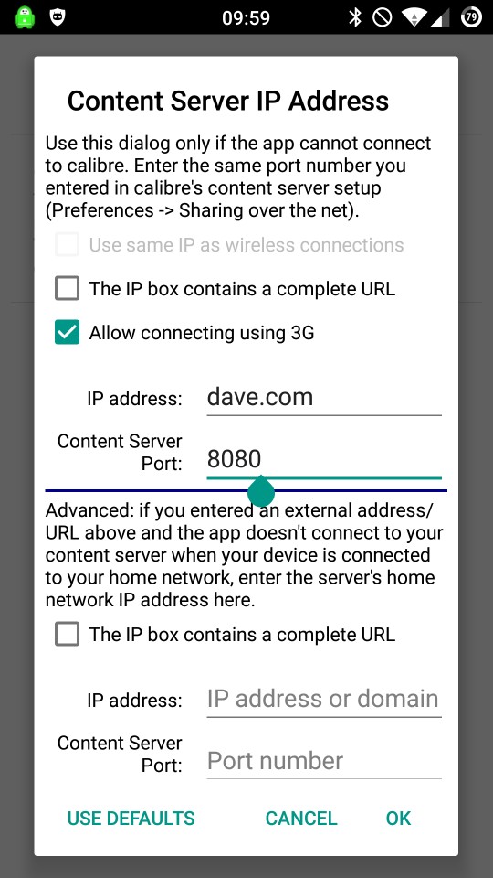

I can get it to connect properly using http on port 8080 using the following configuration:
The issue is that nowhere in that configuration dialog can I find a setting for SSL, so as a result, I cannot figure out how to get it to recognize HTTPS, because this configuration:

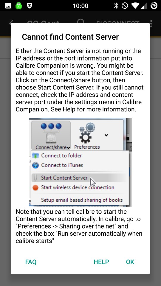

produces the following upon my attempts to connect:
Any recommendations on how to make it work with SSL? Because I don't want to have to change my password after every time I connect over HTTP.

I took the liberty of turning your images into attachments. I couldn't read it as it was, and the post also violated forum rules.
Have you tried https://dave.com:44344/?
I use SSL with CC. My content server is set up behind apache. Apache handles authorization (user/password) and forwards requests to calibre using the rewrite rules described in calibre's manual. Since my apache server listens on the standard port 443 the url https://my.server.org/library works. However, I just tried https://my.server.org:443/library, which works as well. The URL https://my.server.org:444/library does not work, which demonstrates that the port in the URL is being respected.
This web page seems to describe what you want to do, use stunnel as an https proxy to connect to an http-only web server.
NB: CC doesn't do certificate management, so self-signed certs won't work. CC must be able to validate the cert with some known authority.

I tried https://dave.com:44344/ and that had the same result.
Did you check the "contains a full URL" box? I imagine you did or you wouldn't have been able to leave the port box empty.
Does that URL work from a web browser on the device? If it doesn't then it won't work with CC either. If it does work from a web browser then is should work from CC. Send me a debug log and perhaps I can tell what is going wrong.
If your stunnel is using letsencrypt then that might be the problem. There seems to be issues with the root cert.
Yes, I did that.
It works fine from the browser with just https://dave.com:44344
Yeah its using letsencrypt... that's probably at the root of the issue =(
I attached the relevant section of the debug log. Thanks for taking the time to help out P:
