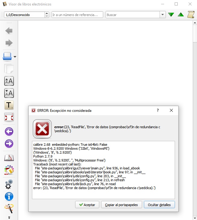

Hello calibre 2.66 and 2.68 using ebook_viewer.exe (windows 10) gauge gives me the following error, someone has the solution? .
Thanks
calibre 2.68 embedded-python: True is64bit: False
Windows-8-6.2.9200 Windows ('32bit', 'WindowsPE')
('Windows', '8', '6.2.9200')
Python 2.7.9
Windows: ('8', '6.2.9200', '', 'Multiprocessor Free')
File "site-packages\calibre\gui2\viewer\main.py", line 936, in load_ebook
File "site-packages\calibre\ebooks\oeb\iterator\book.py", line 97, in __init__
File "site-packages\calibre\utils\config.py", line 203, in __init__
File "site-packages\calibre\utils\config.py", line 213, in refresh
File "site-packages\calibre\utils\lock.py", line 76, in read
error: (23, 'ReadFile', 'Error de datos (comprobaci\xf3n de redundancia c\xedclica).')

Old 09-23-2016, 01:21 AM   #2
Posts: 45,658
Karma: 28549046
That indicates the disk you have your calibre configuration directory on is malfunctioning. Try moving the configuration directory somewhere else using an environment variable as described here: https://manual.calibre-ebook.com/cus...ment-variables
You can also google windows ERROR_CRC for more possible solutions.

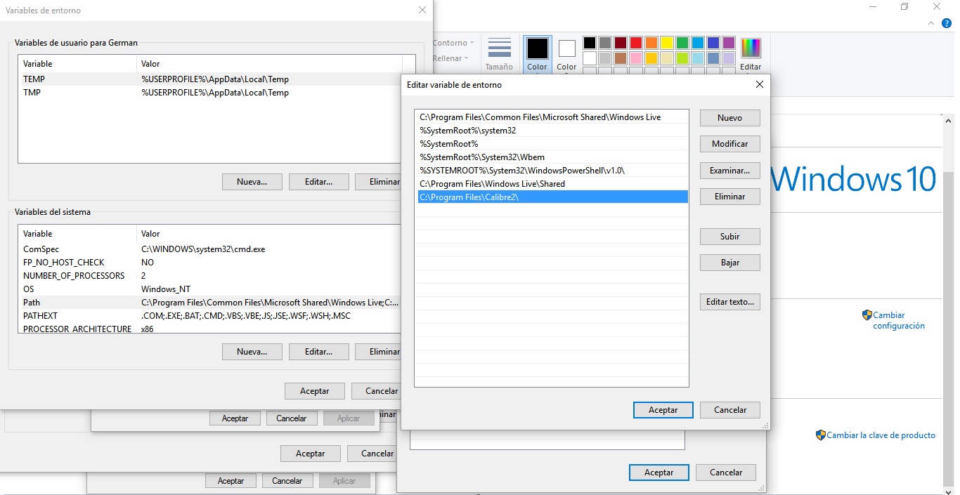

Old 09-23-2016, 09:46 AM   #3
gsevrain
gsevrain began at the beginning.
Join Date: Sep 2016
Device: Calibre
The problem continues.
Thanks.

Old 09-23-2016, 10:33 AM   #4
Terisa de morgan
Terisa de morgan's Avatar
Posts: 6,689
Karma: 13151331
Location: Madrid, Spain
You have not defined any environment variable (as I can see) to change the configuration directory. And a "error de redundancia cíclica" in a file you haven't downloaded is because of a faulty disk.

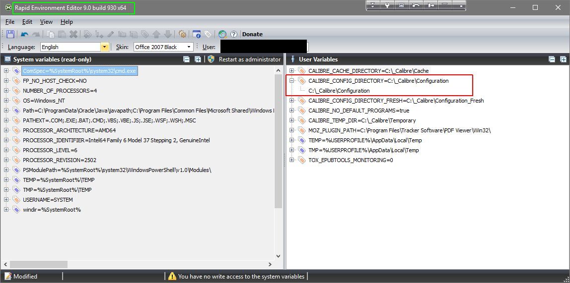

Old 09-24-2016, 05:33 PM   #6
Posts: 22,042
Karma: 30277960
FWIW- I use Rapid Environment Editor, viz

Old 09-24-2016, 07:34 PM   #8
Posts: 48,646
Karma: 174510110
As you are getting CRC ( comprobacion de redundancia ciclica or cyclic redundancy check ) errors on your hard drive, I'd suggest not worrying about Calibre and start worrying about getting a full backup of your hard drive before replacing it. My experience has been that when a drive starts throwing up errors, it's past time to replace it.
You might want to check that your new hard drive is supported by a disk cloning software to allow copying your old hard drive to the new hard drive as that makes the hard drive replacement procedure a lot easier.
