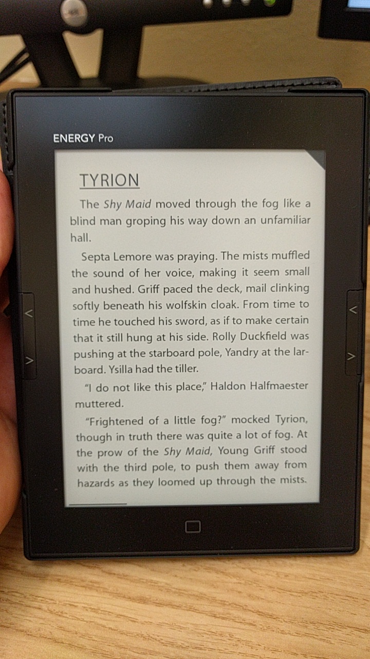

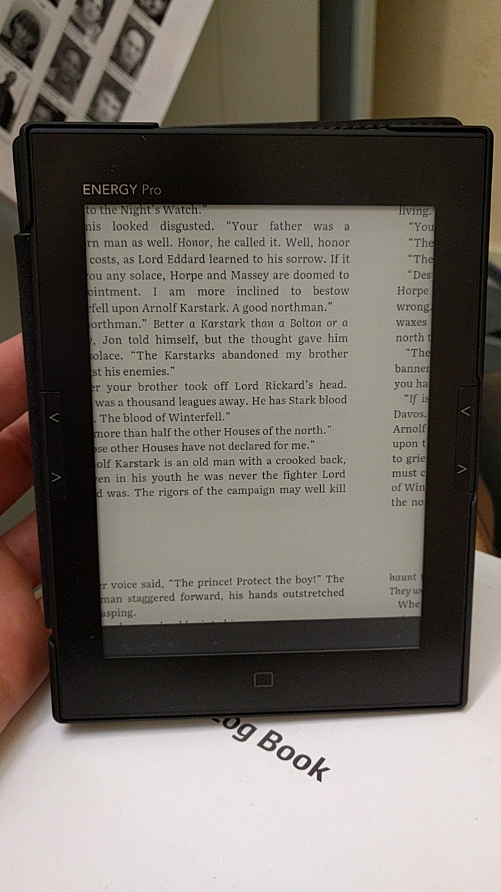

I have attached 2 photos, (note to moderator i have done my best to reduce the file size taking the picture at the lowest resoltion my camera can 0.9 mega pixels.)
One picture shows how google play books looks with bits of text all over this place, epub downloaded directly from google using their app, unaltered with completely, not touched other than getting to my place. And note its black bar the bottom which root is required to remove from any other reader than fbreader
The other photo shows fbreader looking clean and sharp using a drm free version of the same epub, just lacks the functionality of syncing that google play offers out of the box (that i can see). I added the pictures because its hard to describe how messed up google is making my book appear

Old 07-08-2016, 08:35 AM   #6
DiapDealer
DiapDealer's Avatar
Posts: 28,915
Karma: 207182180
Do any untouched epubs display properly using Play Books? If not, my guess is that Play Books isn't compatible with your device, even though you're able to install it from Google Play. Incompatible vendor changes sometimes cause these sort of support gaps on non-mainstream devices. I've no idea if the Energy Sistem Pro HD's Android (Jellybean it appears) is completely stock or not.
