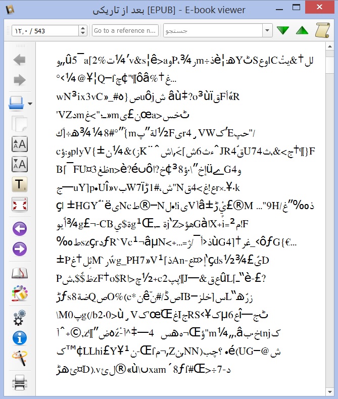

persian e-books can not be shown properly. what should I do?
hello
I just installed Calibre E-book reader and it's a really great prgram with good options including conversion ebooks to pdf.
though It works fine with English e-books, I have a problem with reading Persian e-books. it can't show this language properly. I really need to read Persian e-books and I couldn't find any other e-book readers which can show Persian properly.
so I joined this forum to find a solution and I'll be thankful if there's anyone to help me.

From the screenshot, it isn't using the correct font. I assume the title bar is correct, so it means you have an appropriate font on the PC. So, open the preferences of the viewer, and select an appropriate font.
