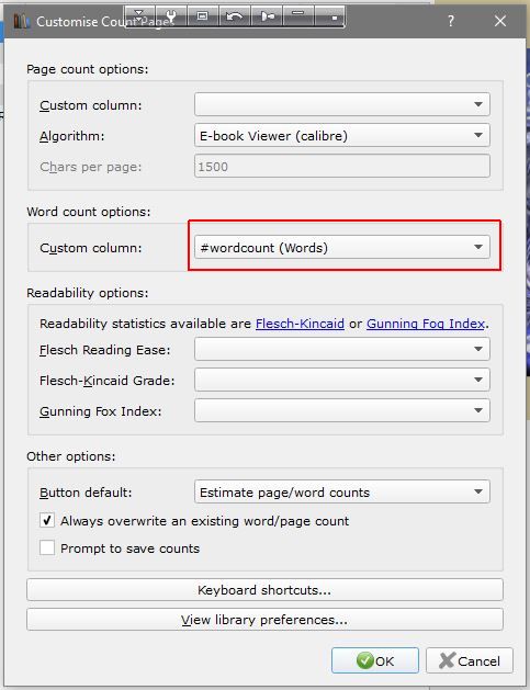

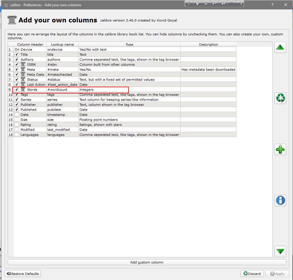

@CrazyDutchwoman - the row numbers have been there for as long as I've used calibre, the following is from a tips and tricks blog entry in 2011 ==>> http://blog.calibre-ebook.com/2011/1...-and-feel.html
Can you post your Count Pages configuration set sup and your custom columns list, viz:

Hi . I checked and it seems I do not have a setup anymore.
Now thinking about it. I think this could have happened because I got the update now message so I clicked thinking it would update automatically, but when I noticed they brought me to the website where I had to newly install calibre I cancelled and then when i came back all my books were gone.
Does this mean I should have my old setup preferences somewhere?
eta: I checked and I see to my delight (I think) in my calibre files in explorer the normal metadata one but i see also one metadate pre restore. It is only 127 kb though while the other one is 3963 kb

read the document of that plugin, then you will know how that plugin works.
its just like that.
Count Pages wants us to create Custum Column
#pages, when you created it, make sure you input integers in setting of custom column, then configure the plugin to look after the custom column you created.
CMIIW

  1. Can you tell us what operating system you use?
  2. Do you have your library?
  3. Please post an image of your custom columns - Preferences->Add your own columns.
  4. Did you uninstall calibre before you installed the new version (2.46), there is no need to do that, in fact I would advise never to do it. But if you did uninstall the existing version then how did you do it ?
It could be that you have the column definition(s) but somehow you lost the Count pages configuration. If that's the case all you have do is to configure Count Pages to use the existing custom column(s) and you'll be 'in business' - the column(s) will have retained the previously computed values.
