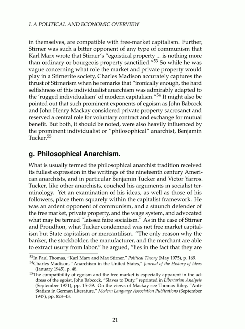

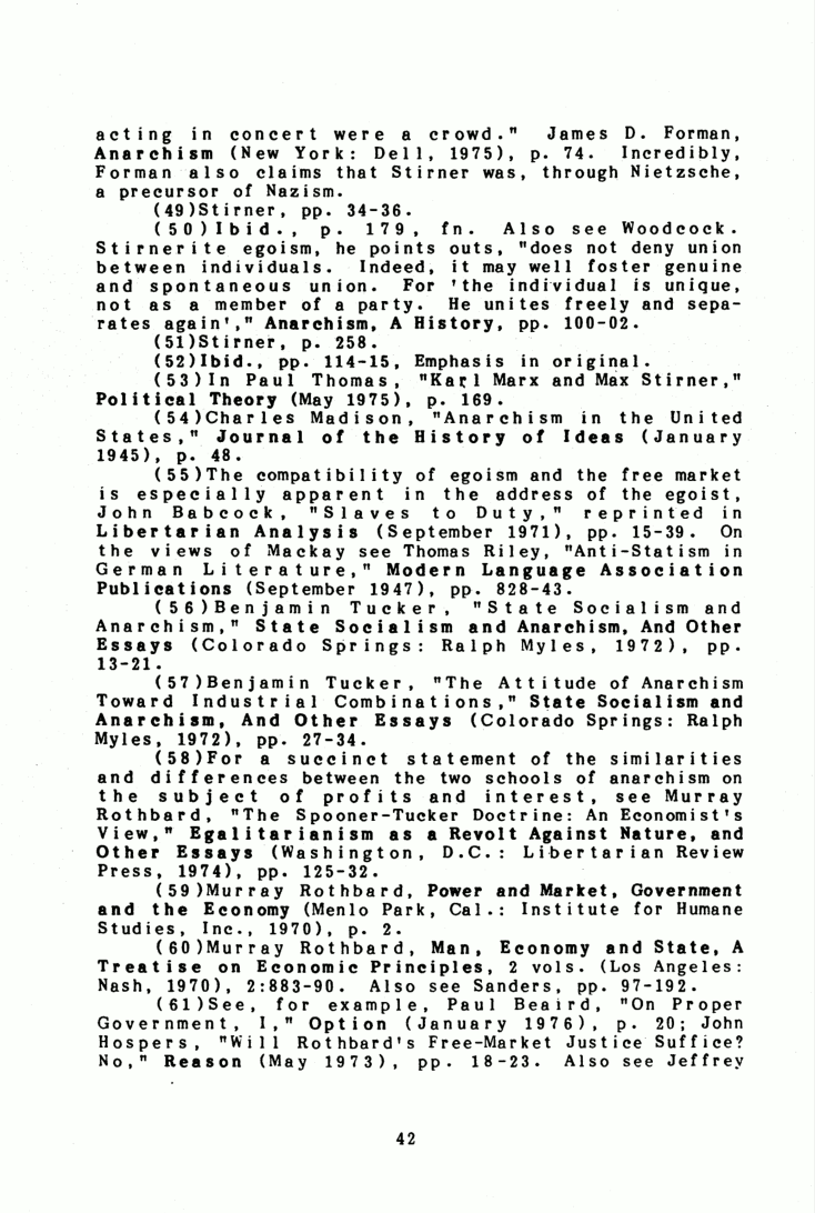

Side Note: This reminds me of a book I digitized back in 2014. It was written on a typewriter, and the author used bold instead of italics:
Clearly, you can tell the bold text was meant to be italics, and the (50) markup was meant to be footnotes.
Modernizing and retypesetting the book, I updated to this:
The new print/ebook doesn't have an underline in sight.
(The original also had ASCII art diagrams/equations... which I recreated + vectorized.)
