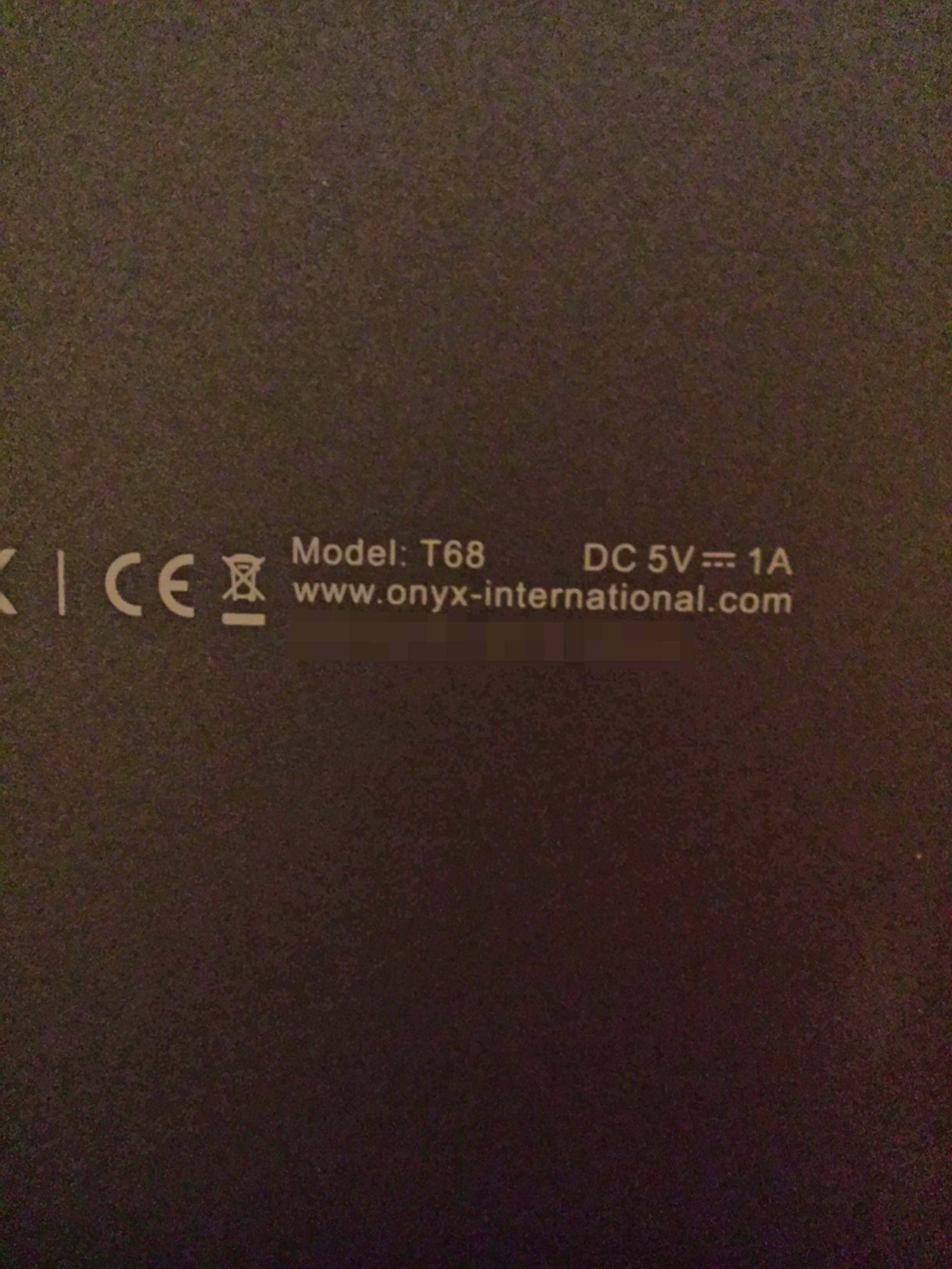

The back of my T68 says "1A": so, what charger should i use if i don't want to have problems? I'm a little bit confused. Thanks a lot for your help! :-)

You should use your Samsung charger because the general rule the charger should be able to provide at least the required current. Your T68 will simply get from it as much current as it needs (1A). Just... never mention this to ArtaTech if you ever ask them for service.
