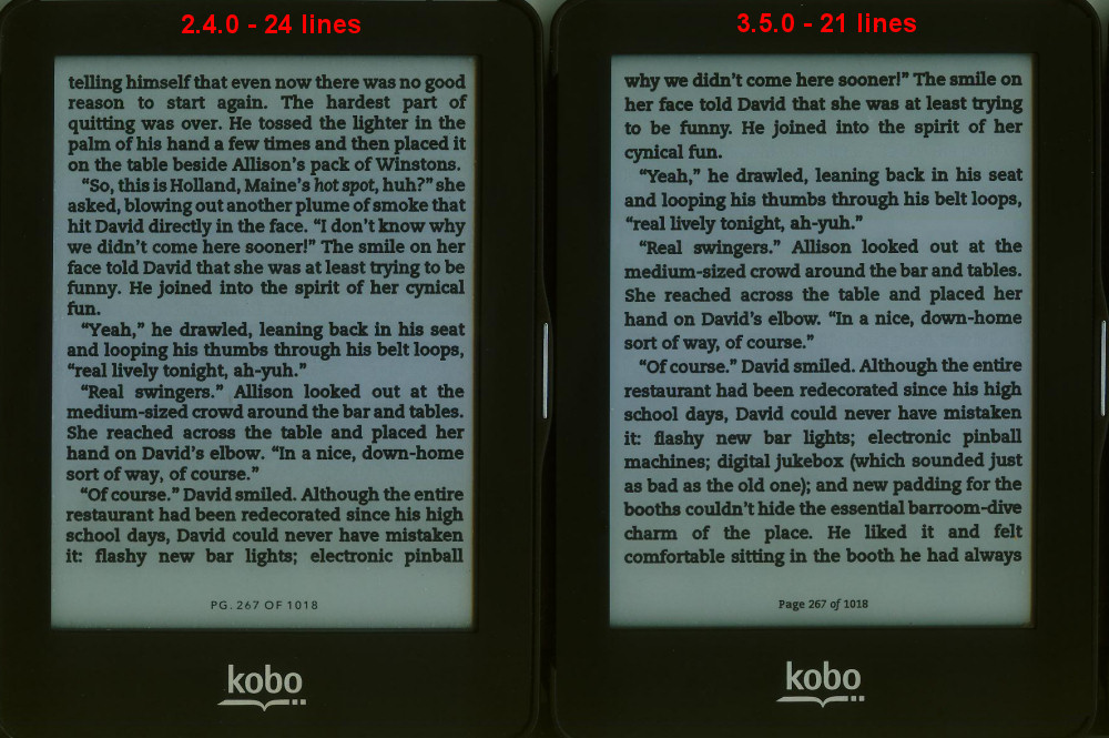

Since I've picked up a spare Glo I've been playing around with the newest firmware just to see differences. One thing I can't get right though on the newer firware is line spacing. The reader at the left has my preferred firmware of 2.4.0, the reader at the right has 3.5.0. The identical epub file is loaded. Both readers use the same size font, readingFontSize=28.
In the Kobo eReader.conf file, I manually changed 2.4.0 to readingLineHeight=1.225, which was posted as a tip to decrease the too wide line spacing at the time. The Kobo eReader.conf file for 3.5.0 has readingLineHeight=1. Yet the one with the smaller specified line spacing has wider spacing and 3 less lines per page.
What am I not getting about the newer firmware to force smaller spacing between lines like on 2.4.0? I tried lowering it below 1, but that doesn't seem to work at all, unless I just didn't hit on the magic decimal number.
Name:	Line Spacing.jpg

The line spacing scale changed in firmware 3.0.0.
Before 3.0.0 the line spacing slider set the readingLineHeight value in the config to a value in the range 1.3 to 3.0, and was equivalent to the CSS line-height property.
From 3.0.0 on the line spacing slider sets the readingLineHeight value in the config file to a value in the range 1.0 to 3.0, but it is a different scale and not equivalent to the CSS line-height property.
I think readingLineHeight=1.3 in the old firmware gives roughly the same line spacing as readingLineHeight=1.0 in the new firmware. So if you wanted to set the spacing the same as 1.225 in the old firmware, you would need to use a value slightly less than 1.0.
In the new firmware readingLineHeight does not have a lower limit, by editing the config file you should be able to set it to a much tighter spacing than in the old firmware. On my Glo values such as 0.75, 0.8, etc. work and give extremely tight spacing.
Edit: One thing to watch out for if you change readingLineHeight by editing the config file: If you open a book that had already been opened before you made the change, it will not use the global value from the config file but a book-specific one from the database. You can use the KoboUtilities plugin in Calibre to change the line spacing for a book that has already been opened, or there is a line spacing patch that allows you to change the values set by the line spacing slider, which avoids the need to edit the config file.
Edit2: If you're interested in the details of the line spacing slider values, the slider in the old firmware selected from 9 values {1.3, 1.35, 1.4, 1.6, 1.775, 1.9, 2.0, 2.2, 3.0}, while the slider in the new firmware selects from 15 values {1.0, 1.05, 1.07, 1.1, 1.2, 1.35, 1.5, 1.7, 1.8, 2.0, 2.2, 2.4, 2.6, 2.8, 3.0}.

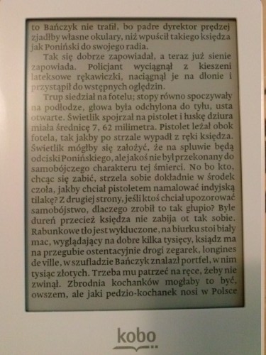

I made some tests today and I managed to lower the line height, but it works only in epubs. I converted the book to an epub with these parameters (Look&feel section): "Minimum line height=100%", "Line height=15.0".
With the font size=27 and margins=1 I am pretty happy with the result (I've got 27 lines of text). Unfortunately this method does not work with kepubs, or just maybe I can't do it right.
Another thing: I've noticed that some fonts give lower line height (e.g. Gothic), so I think I'll try to find a serif font that gives me similar effect in kepubs.
