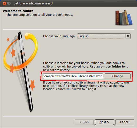

As per the FAQ link, when you start calibre for the first time it should ask you where your calibre library is located (screenshot #1). You just select the folder on the HDD/flashdrive.

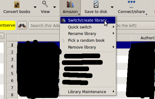

Or if you already started calibre and it created a default library, you can add a new library from the Switch/Create Libraries dialog (screenshot #2)
You can also use calibre portable instead. It will save all settings/library and stuff on the flashdrive/HDD. Simply move the Calibre Library folder (as per the FAQ) into the "Calibre Portable" folder, replacing the (empty) one that was created when you installed it. Then run calibre directly from the flashdrive/HDD.

Question: Are you sure calibre is using the right library folder? (Perhaps it got switched?) You can check the current library folder from the Switch/Create Library dialog (above).
If the database got mangled (calibre is using the right library with all the book files):
  1. First, copy your library to a backup folder. (Backups are always good.)
  2. Then, run Library Maintenance ==> Restore Database.
It should rebuild your library based on the actual files in it. Hopefully that will fix it.
