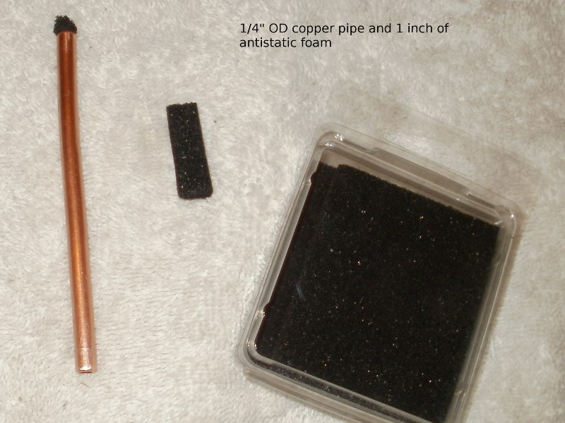

Homemade capacitance stylus
This is about as simple as it gets.
1. A length of 1/4" copper tubing to fit comfortably as a stylus
2. A one inch, or so, of a foam strip cut from the foam that a CPU or other
IC component comes stuck into.
Smooth all the cut edges of the copper tubing with sandpaper or emery
cloth.
Compress and push the foam strip into one end of the copper tube until
only 1/4" sticks out. (Trim it to a point if you want.)
Works fine on my Eee Pad Transformer.
Luck;
Ken
PS; If you use a little longer strip and fold it in half then compress the foam and
push the open ends into the copper tube you can get a denser less spongy end, but
if you overdo it it doesn't work as well.

The simple capacitance stylus I made would work but you might want to wrap some of the conductive foam around the part you put in your mouth. The copper would taste bad and could be toxic over a long exposure. The conductive covering should let it keep working. There needs to be a conductive path between your body and the touchscreen.
