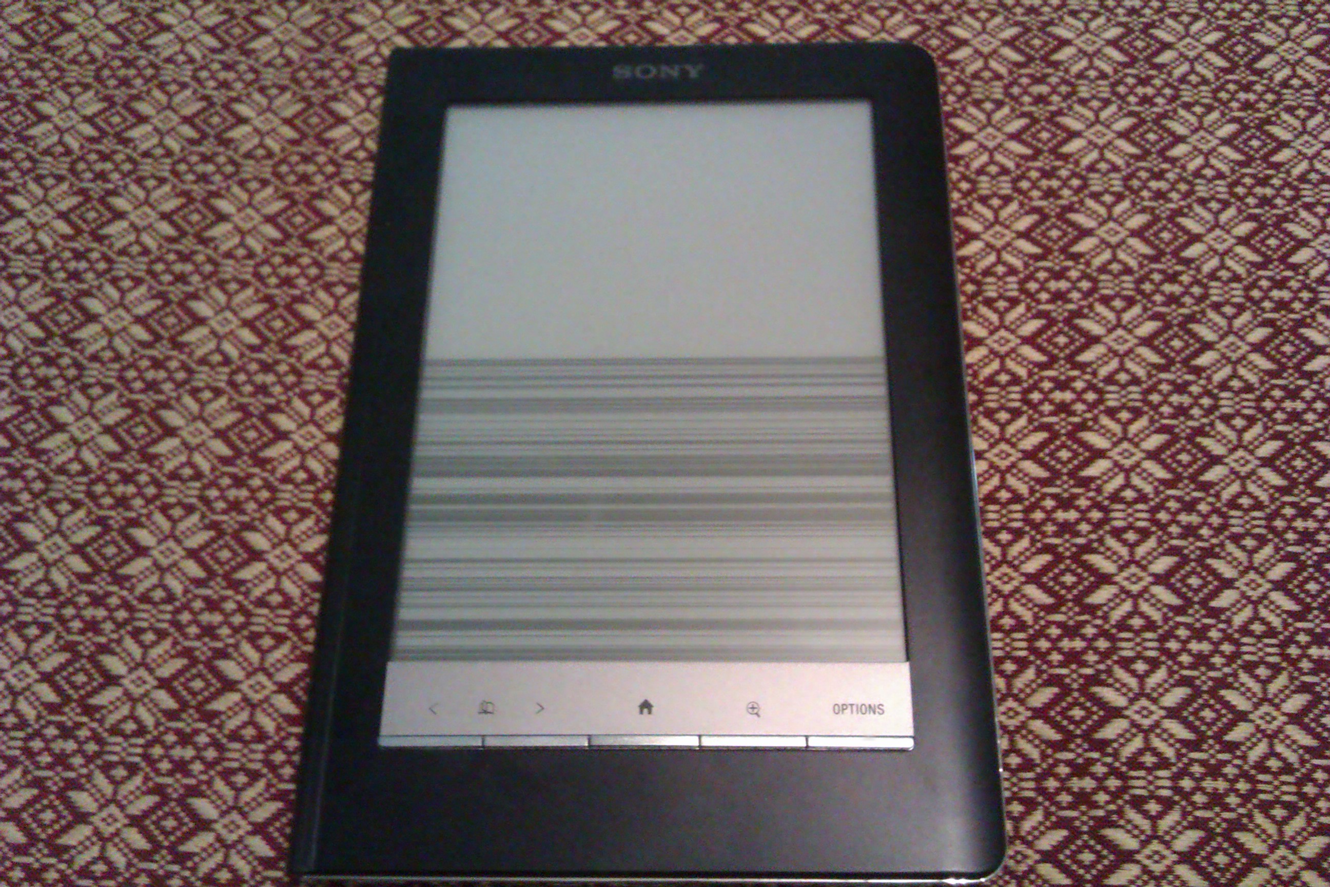

Can you post a picture of the screen? It may be that the screen is damaged/stopped working, in which case you are out of luck. PRS-600 is a touchscreen, so it must be even more sensitive/fragile than non-touchscreen epaper readers.
Picture is attached....
I've attached a smaller file for faster loading...the reader has never been dropped or banged around. It quit working when I went to recharge the battery from USB port on laptop. Something I've done many, many times...

Just justifiable guessing:
I think that's no mechanical screen damage but an electronical one. Meaning that (maybe) one of the screen controller chips has gone (mad).
If that do not solve by itself (that can be possible in some cases), I think there is no solution but buying a new one.
